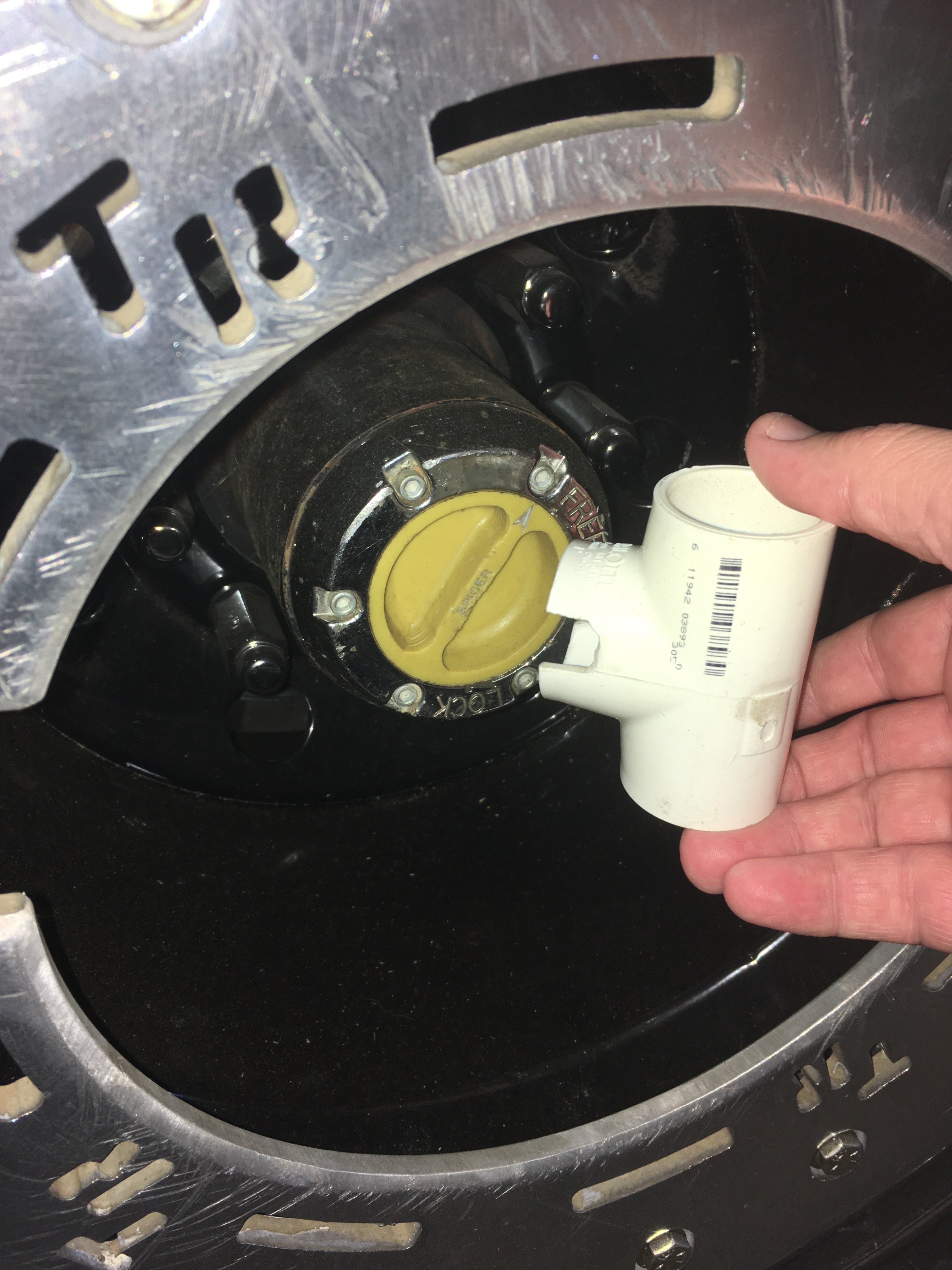

The pvc locking hub turner tool for spicer hubs.

The PVC locking hub tool @obijuank5 mentioned (1.5" PVC tee)
