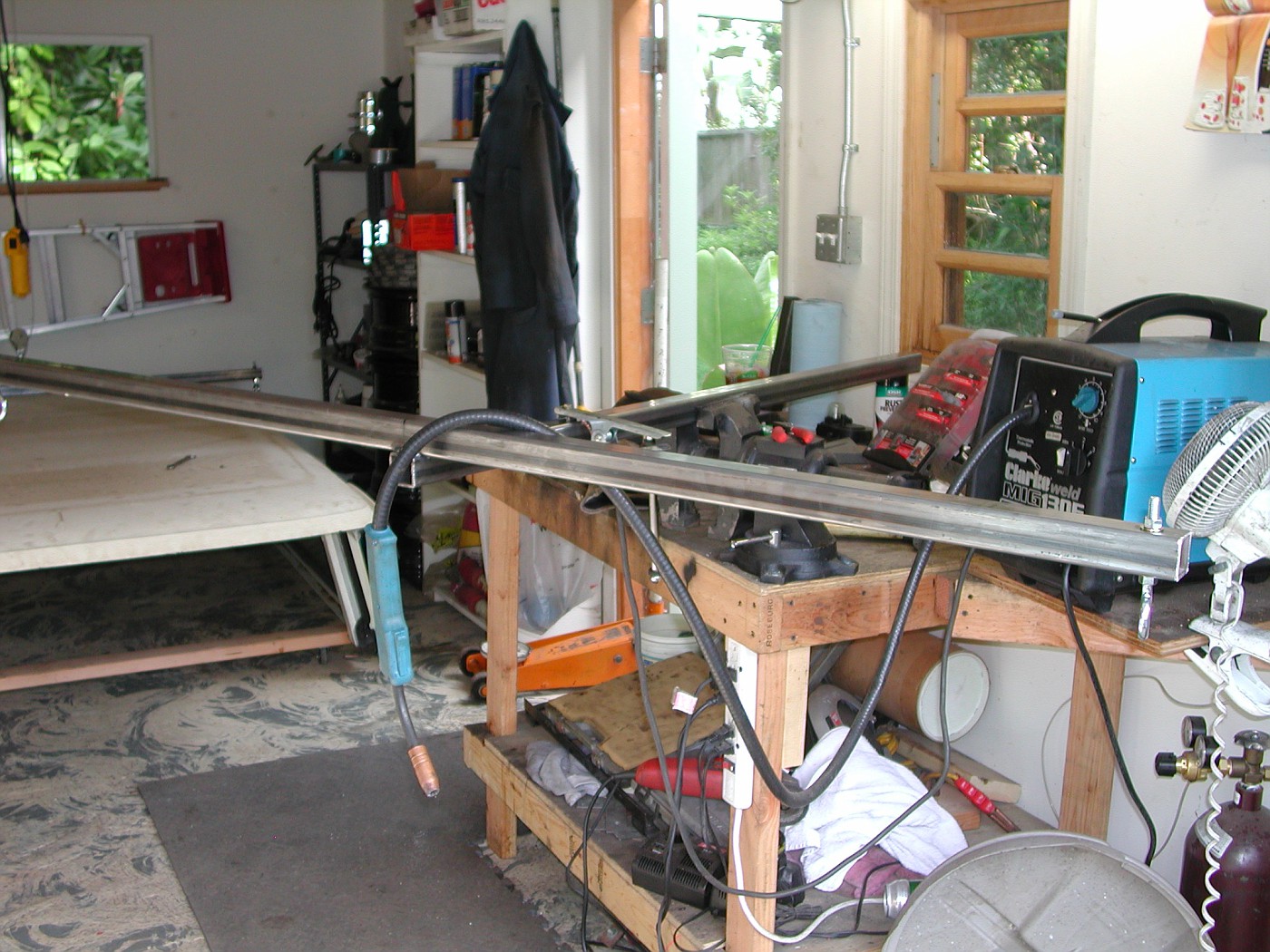

Bought my Clarke 130E online.the price is what sold me.Mine is for gass use only.
Works great for me.No heavy welding here.I have maxed it's duty cycle a few times but I'll just take a 5 min. break and have a cool refreshing beverage.
I started useing a small fan.Put it up against the finns on the side of the welder.I haven't maxed it out since.
As far as tips and consumables go the gun is made by lincoln so all those consumables will fit the Clarke gun.:thumb:
I'd say one drawback of the Clarke is it's only a 6ft gun/hose assembly
This is the only pic I have.You can see the bottle under the welder.
The case look remarkably like a Lincoln too...I wonder how they'd compare side by side.

your right , it does. i bet they are just a different color shell.
