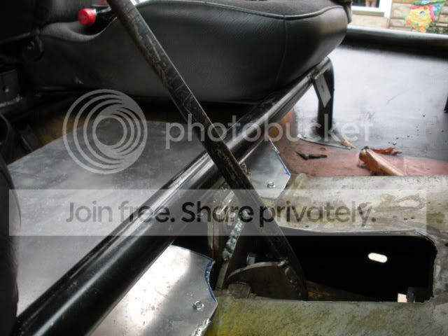

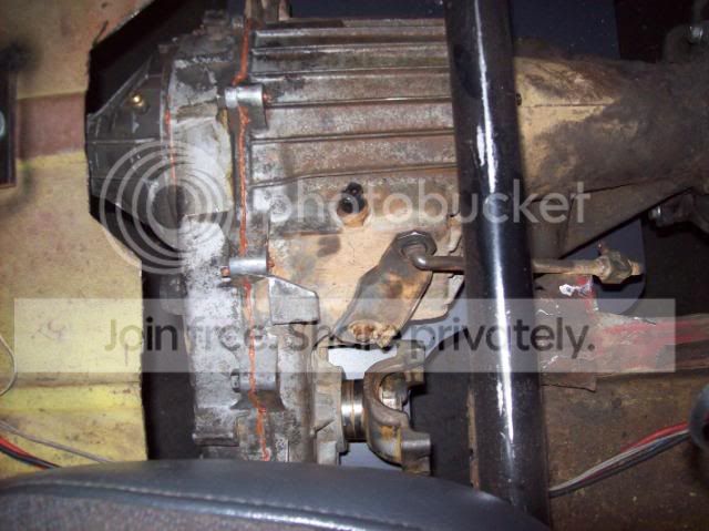

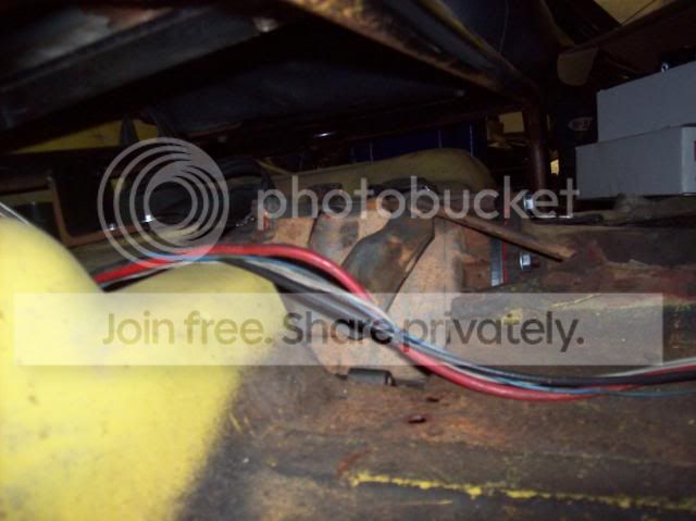

mine is clocked belly flat.no body lift and lots of cutting
upper t case mount,box and custom 208 shifter
Inside the cab.

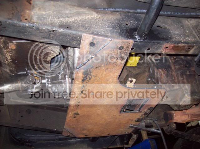

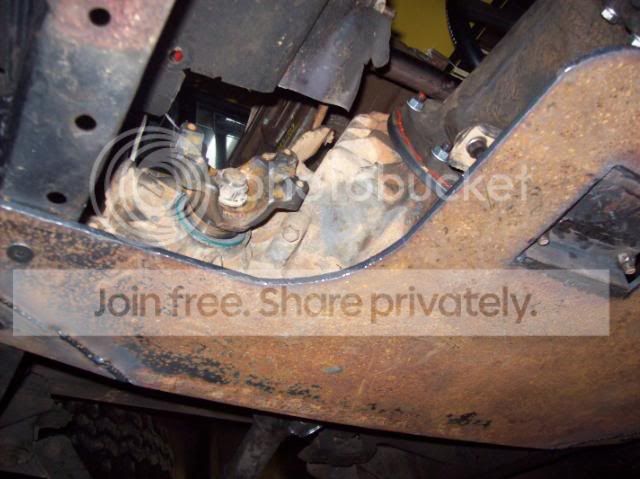

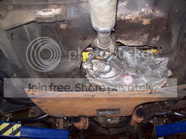

Clocking the case is the easy part. There are quite a few other things that need to be done to make it work. Shifter linkage, support rod, front driveshaft, and exhaust are all things I had to modify. I have a 1" body lift and had to do a little floor rework too. Also clocking the case does no good if you don't make a custom crossmember and skid. I am happy with the results though.
