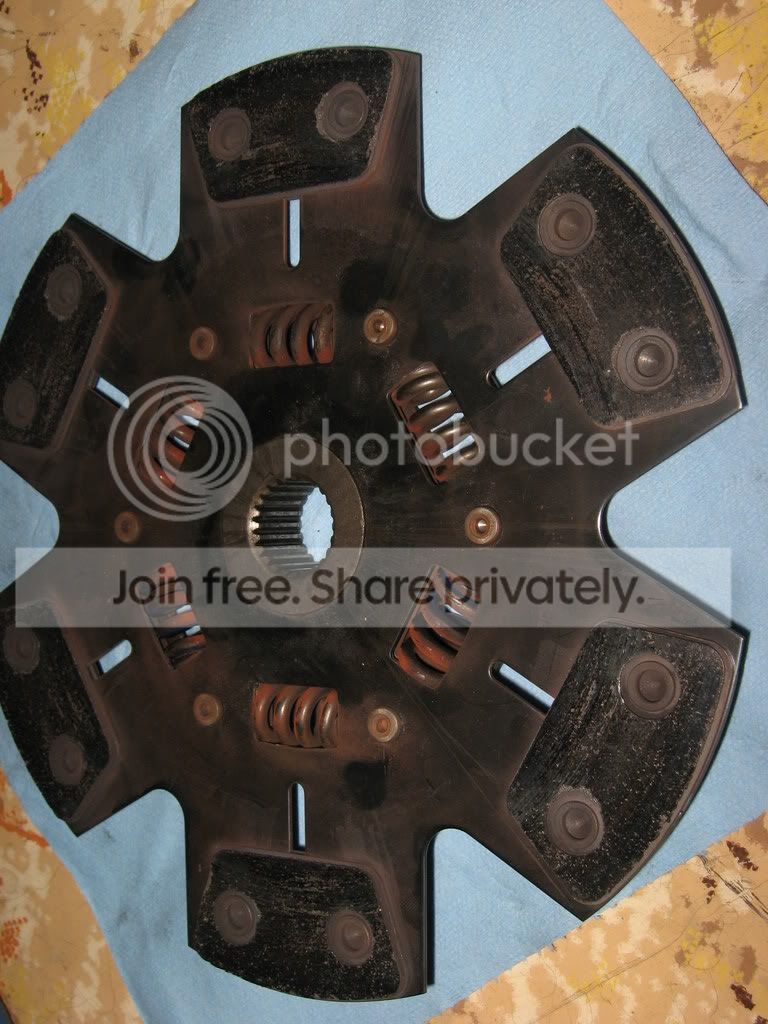

Has anyone ran a puck clutch. I guy wants me to put one in his plow rig, and im thinking I want to stay with Luk
I never tried one,but have driven a few larger trucks that had one installed for plowing,one was a IHC 1600 Loadstar--there is no "riding" one of those clutches,its either engauged or disengauged,it is ON or OFF,and take offs are a lurch ,especially on hills..but that was the only clutch that truck didn't eat in a year or less,before they put that one in it ,it needed a new clutch every spring...
I had a puck clutch in my first cummins I owned years ago, and everything he said about them are true. IN or OUT.
