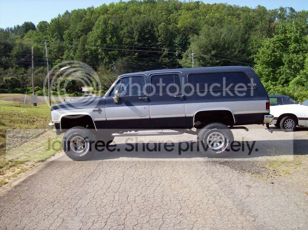

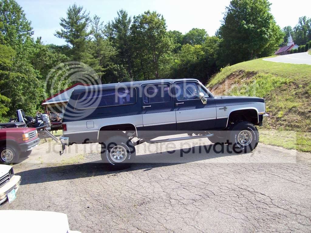

dont know if this works or not here is my burb.
