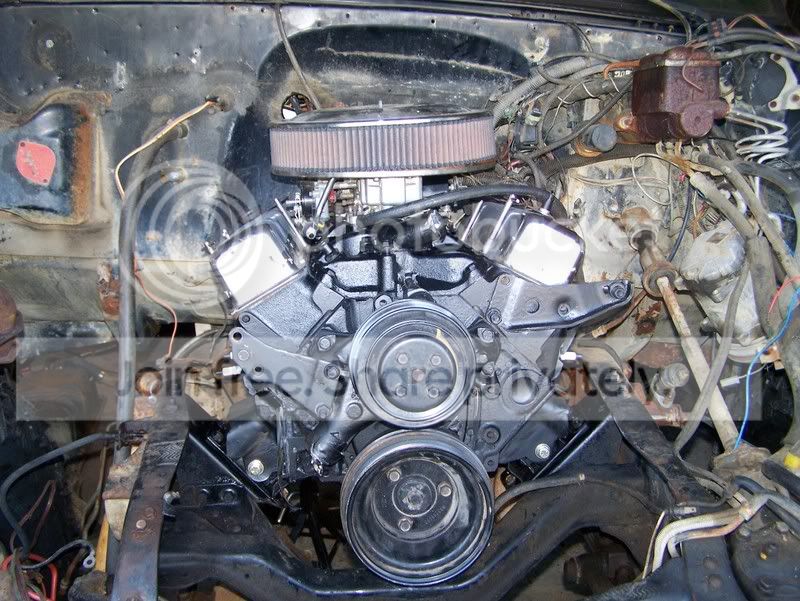

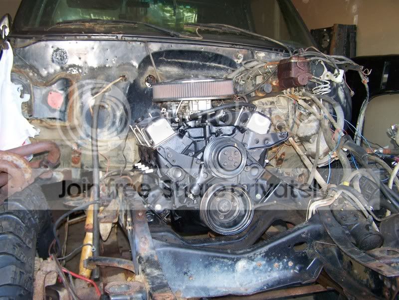

motor and tranny and transfer case are in.. old fuel tank is out, waiting on the cell to get here to hook all that stuff up. just need to throw the driveshafts in and the work under the truck is done. here are some pics...
kind of hard to take any pics other than that to show the work I've done.. in the pics the carb and air cleaner are just resting on there... I need some type of exhaust manifolds.. I have a set of headers that came from my trans am and they won't fit between the frame and the motor... who woulda thought that there is more room in a trans am than there is in this truck, when this truck came with a big block.... whatever...

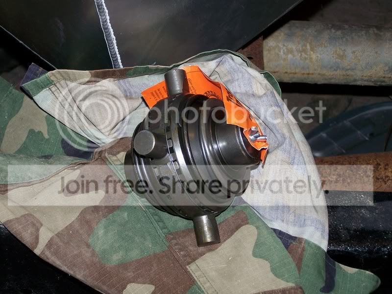

some new parts came the other day!!! :D
rear locker:
same:

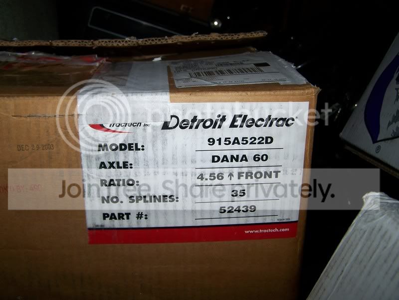

Pretty sure the sticker says it all:
