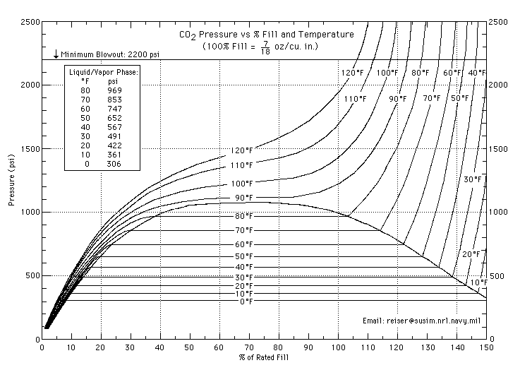

FWIW CO2, depending on ambient temp, is roughly 800psi in the tank while N2 is 2500 psi. This graph might be helpful, dunno.

Thank you for the replies sorry my computer has been down for a few days, I just have a few more questions. I got the 15 lb. co2 bottle from a welding supply shop because it was free. The guy there told me that they can only fill up the bottles to the specified amount stamped on the bottle, so do Powertanks have these numbers on them? What can I do for a regulator that wont break the bank, the one at the welding shop was $140 bucks and he didnt know much about the flow of it? Also about how many fills can I get out of this bottle if I have 38'' tires?
