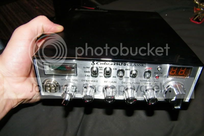

Would you buy it at 40 bucks? guy said he used it for a month while trucking, just sitting now, keeps being posted cheaper and cheaper. Anyway to test it? (12v battery like ive tested radios or what?)

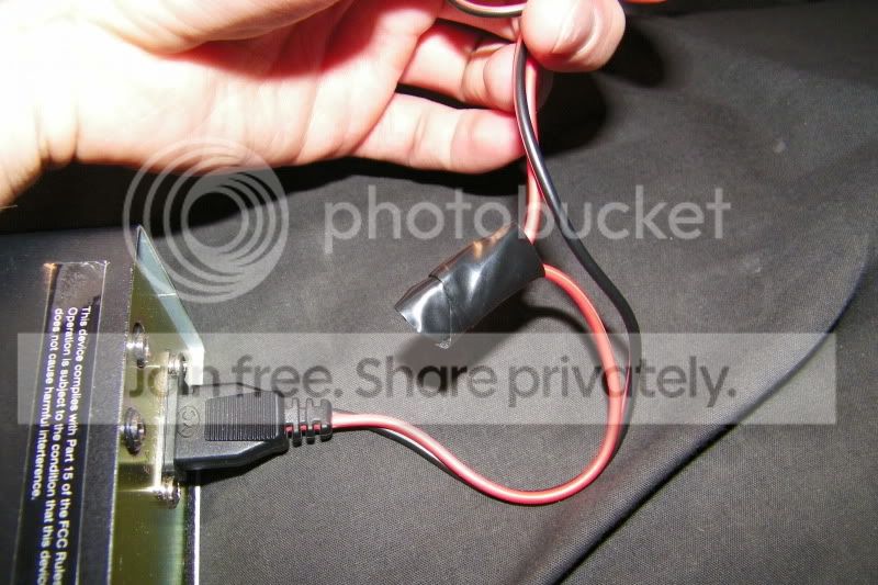

It has it's own internal speaker but don't key the mic without an antenna on it. Otherwise, just hook it up to 12v and it should be fine. I have one and it's a decent radio. $40 is reasonable. I wouldn't sell mine for that.
Good radios, I own 2 of them. Ive had one for 16 years still works great, more important is a good antenna and coax. $40 is cheap if it is as he says... A reman cobra 29 sells for about $80, $119 new. Take it to a cb shop and have it peaked an tuned and have them match it to a good antenna that they recommend and it will last a long time and perform well. A single Antenna will work better than dual antennas, dual antennas have to be a certain distance apart from each other to function properly, has something to do with wave length.

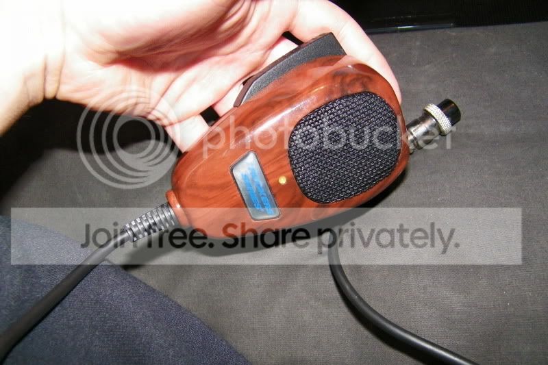

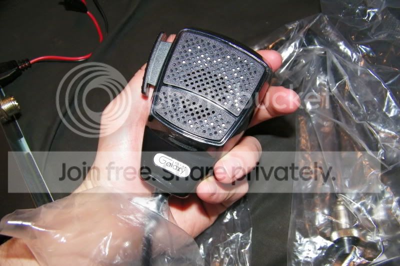

Looks brand new visually, one spline in the wire im still shaking my head at, came with a nice wooden one with adjustable volume on the back, and what looks to be a new galaxy as well.

Make sure you adjust the antenna so the SWR (standing wave ratio) is less than 3:1, a 1:1 match is best,but near impossible to attain..you'll need an SWR meter,that can usually be had for 15-20 bucks at a CB shop or Radio Shack..if you wish to test the transmitter without an antenna,you can use a #1816 light bulb in place of an antenna as a "dummy load"...if the bulb lights up fairly bright with the mike keyed up,and it gets brighter if you speak ,its modulating OK..looks like you may have an "echo" mike,Galaxy made some nice "pirate" CB's back in the day!..

is that the green/red looking thing on the upper left?
Yes. The way you calibrate the SWR is by moving the switch that says S/RF SWR CAL to the SWR position and then whatever channel you're on you will key up the mic and then turn the SWR CAL knob until you get the lowest reading possible on the meter on the SWR line. Ideally you would calibrate for whichever channel you're on but some people calibrate it whil on channel 20 which is half way through a 40 channel CB and then whichever channel you use it is close enough.

Close but not quite on the calibration. Set channel to center of band (channel 20). Switch to the cal position on the s/rf swr cal. key up and adjust the swr cal knob until the meter deflects all the way to the "cal" position. while still keyed up switch to the SWR position. This will tell you the SWR reading. As stated previously 1:1 is ideal I would not operate the radio in transmit for long if the SWR is over 2:1. You change the length of the antenna to adjust the SWR.
