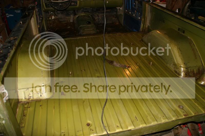

the plan is to replace my rusty current body with this '73:
this truck has some rust, but it's all very minor and serviceable. here it is after i cleaned it up today:

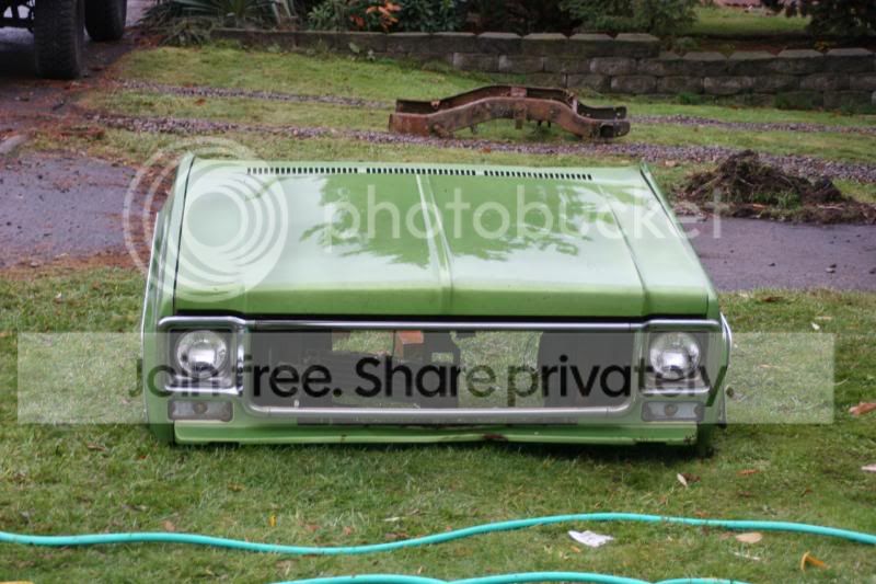

got a real nice hood out of the deal, but the fenders and core support are crap:

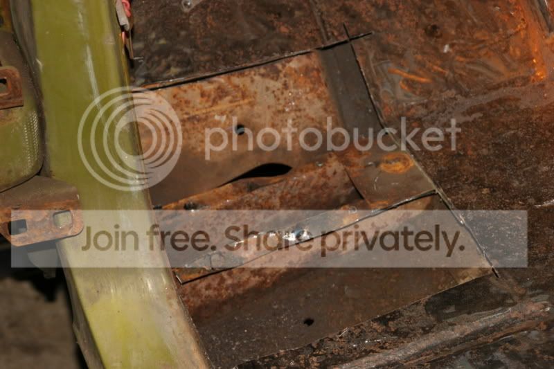

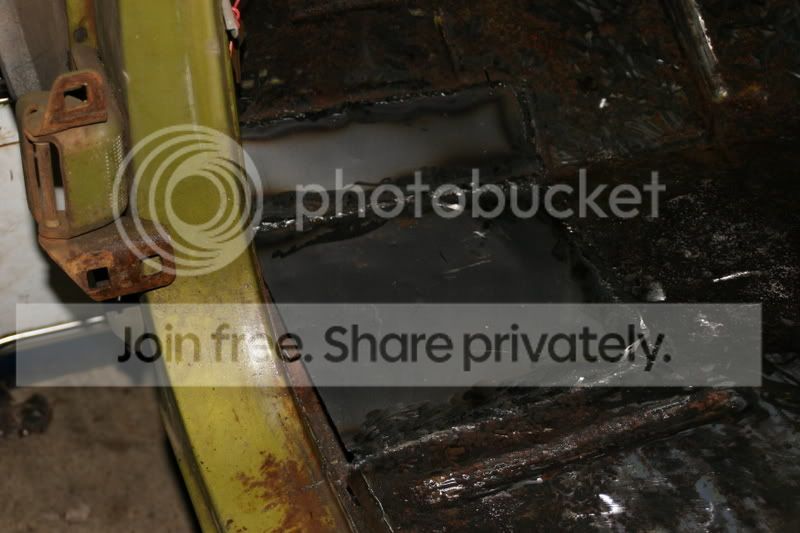

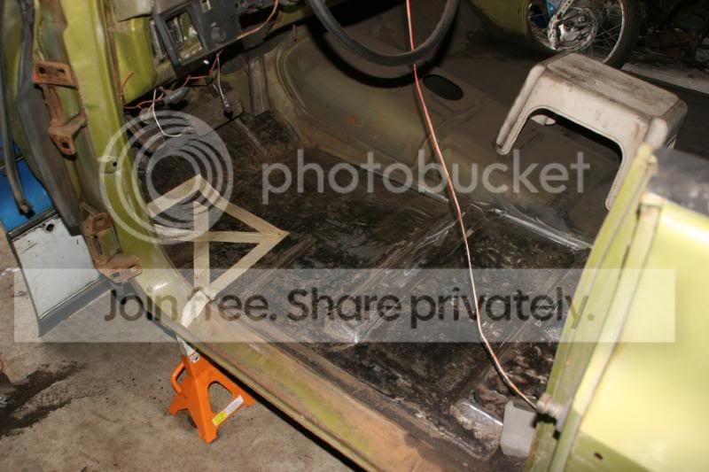

i started removing the rust today. i ground out the rust from the driver's foot well and bed rail. verify this for me, but i think i got it ground down enough to put POR15 on it, then some body filler to smooth it out, then prime and ultimately paint it.
here it is after grinding it down:
the spot "x'ed" out with tape needs to be cut out and replaced. i checked the other side and there's no where else in the floor that needs cut out and replaced.

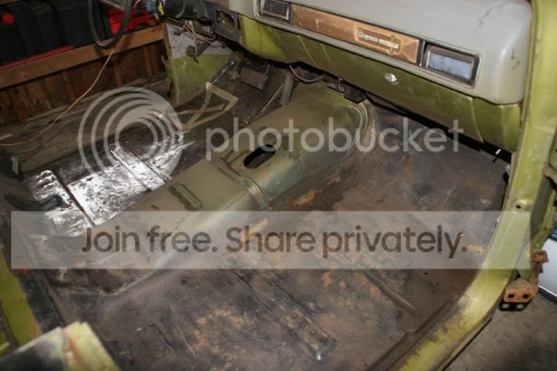

here's a pic for perspective - the passenger side hasn't been ground out yet, so the driver's used to look like this:

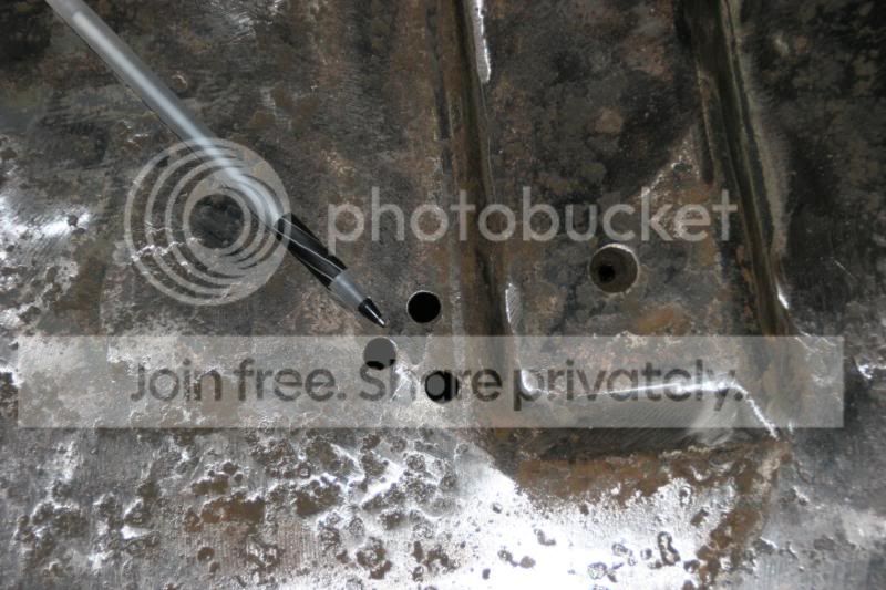

i want to fill in all the holes in the floor, including the seat mount holes because i'm going to mount my seats to the cage. how do you recommend i fill these holes? is body filler enough, or...? pen for persepctive:
i was thinking i'd clean out the bolt holes real well, install a bolt and then grind the head off of it... is that a good idea?

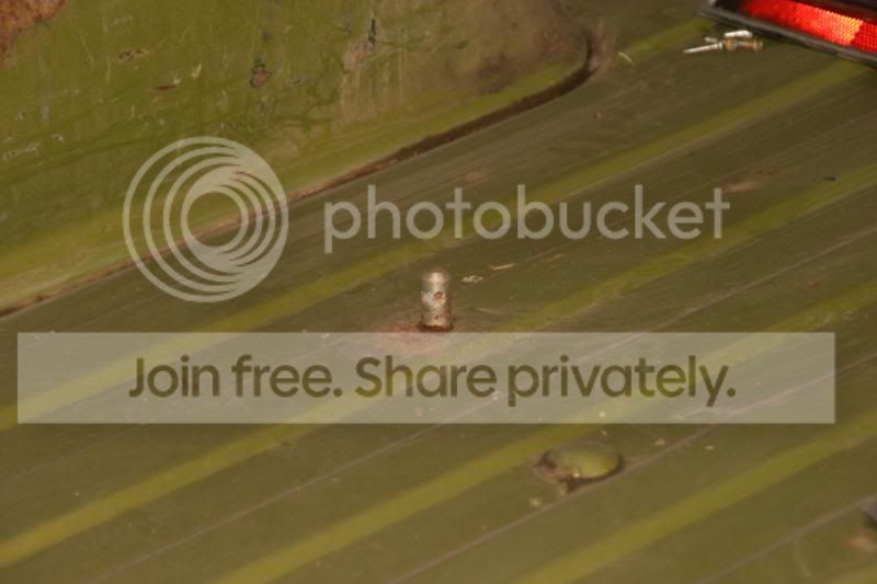

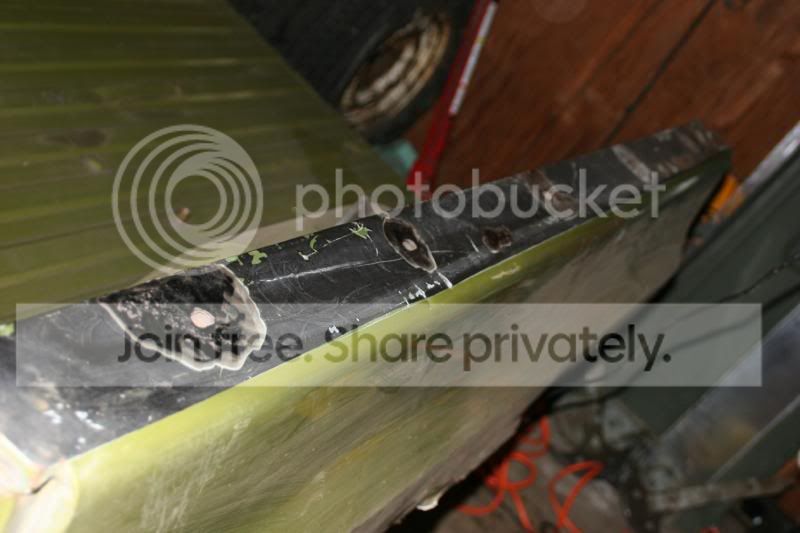

seems common for these tubs to rust around the bolt holes for the topper, so i ground those down too. i might need to use a bit of body filler to flatten them out tho. i think i'm going to remove the cage nuts alltogether since i'm going to be permanently installing the soft top. those cage nuts are always rusty, so i figure if i get them removed, they can't spread their cancer. ;)
what are these?
there's 4 of them in the bed, and i want to remove them since i won't be putting a stock rear seat back in...

I just figure don't mess with it unless you have to.
However if you plan on having to remove a crossmember or two for some reason in the future you might convert that to the bolts now.
If you're good with the welder you can just fill the holes with weld and then grind it flush...I'd just manage to put a big hole in the floor.
The floorboards look very POR15'able. Make sure you use their degreaser and rust convertor on them though. If you use that stuff first it'll work well...if you don't...it's hard to say.
great! :D that makes me happy. when i put the POR15 on there, will the surface be smoothish after application? since i'm going to herc. the floor, do you think that i'd even need to add body filler to smooth it out, or would the herc simply make a nice coat over the bumpy surface?
POR15 self levels, so you won't get many brush or roller traces, but it doesn't smooth out a rough surface all that much.
I forget the recoat time but definitely make sure you have enough time to apply the coat or two of POR15, let it sit for the recommended time, and then start on the Herculiner. Every time I've done POR15, Chassis Saver, or Herculiner I've ended up sitting in a garage or hangar at 2am or later putting on the final coat. Occasionally with work the next morning.:doah:
If the POR15 sits too long you won't be able to get much to stick to it as it's very smooth. If that happens you have to break out the sander.
I wouldn't bother with the body filler. I've got most of the exterior of my Tracker Herculined and you can't even tell which parts were smooth metal and which were pitted with rust. Do at least two coats though. The more the better.

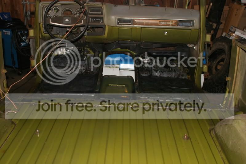

NEW QUESTION: when i go to cut out the rockers and rocker boxes to install/build the integral sliders, do i need to brace the door frame from front to back to prevent the body from buckling?

the holes in the floor i would weld up
the bed rails, your bolt idea sounds like a good idea
the little posts sticking up from the floor, no clue dude

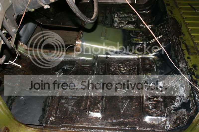

well, i'm in process of POR15-ing the front of the cab... it's late, and i've not even gotten to the painting part yet, so, needless to say, it's going to be nearly an all-nighter! :D while there is a lot of prep going into it, it gives me piece of mind to have done the prep... i think i would have been a bit uncomfortable not doing any prep if i'd used rustbullet. i picked up the POR15 system for $66 today... pretty good price, i think.

i cut out the rusted floor board and welded in a new piece. sheetmetal is freaking HARD to weld! i kept burning holes and whatnot. probably doesn't help that this was the first time i used my new welder and that i didn't cut the replacement to the proper shape so i was trying to fill in ALOT of gap space. anyway, i ground it down and it's not horrible to look at, but with some body filler and the herculiner over it, you should barely be able to tell it's even there! ;) surely not show-truck quality tho...
here's the rotted out portion all removed. that was a bitch.
all patched up:

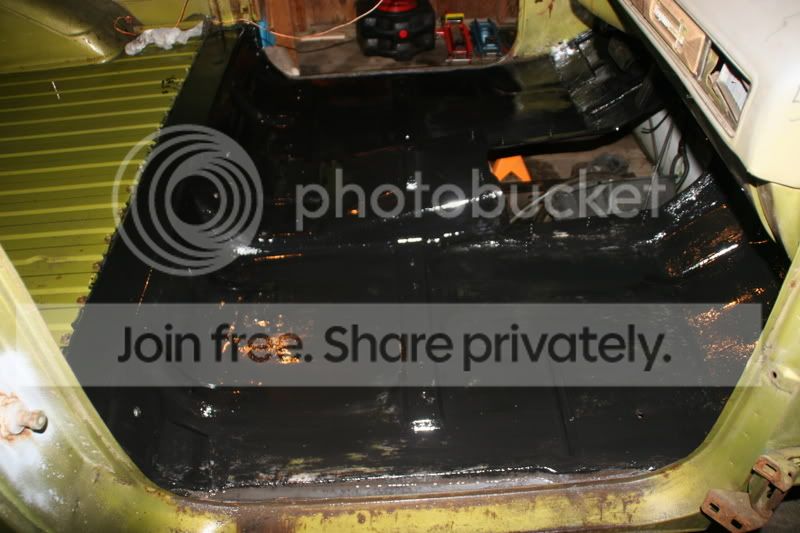

so i started doing the POR15 late this evening.

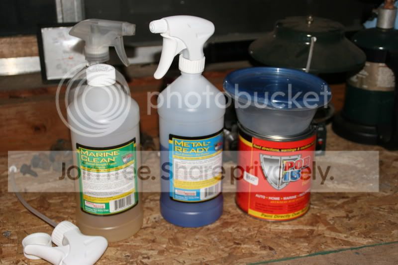

i started by using the "marine clean." sprayed it on and scrubbed it down really good a couple times, then rinsed with water. i dried it up with some clean towels and then sprayed on a ton of the "metal ready". this stuff prevents the rust from continuing... basically it reconditions the metal. instructions say to keep it wet for at least 30 minutes when at 70*F, longer if colder. well, it's 50 in my garage so i'm leaving it on for an hour. it's really starting to shine under there! the hour's up in 15 minutes, so i'll update with progress after i paint the first coat of POR15 on there.
all cleaned up, about to apply "metal ready":
here is how it currently sits with the metal ready on it:
well, got the first coat of it on there... screwed up in one spot tho. you'll see on the bottom of the following pic where i accidentally got some water onto the surface while painting... hope that doesn't present many problems! water and POR15 don't mix... :crazy:
well, i just learned another valuable tip... :rolleyes:
don't use your favorite $20 PURDY paint brush to apply that stuff unless you've got the proper thinner to remove it. i put it in a bucket of water, thinking it would stay workable/pliable/useable, but it hardened up like a rock. :( now i gotta wait till the hardware stores open to go get some cheapo's to use... guess you need one brush per coat.
i decided i'm only going to do 2 coats now, and then once i cut out the rockers, install the sliders and do some other things, i'll pick up another pint and go crazy. :) so far, i've only used about 1/4-1/3 of the pint tho. :D
