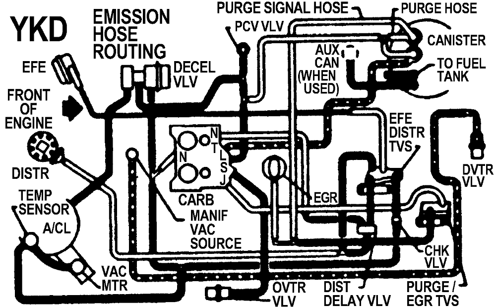

Your bigger issue than the CFM size is if your original setup had a computer controlled q-jet or not. I did a search through Napaprolink through my shop and it's listing both non-computer controlled q-jets and computer controlled q-jets for 1986. Knowing the option content would tell if it was one or the other. Look at the SPID label inside the glove box.
As far as the vacuum diagram goes, google image search is your friend here. Again, what it should be will be dictated by the option content. In this case for the emissions option code. Here's one:
