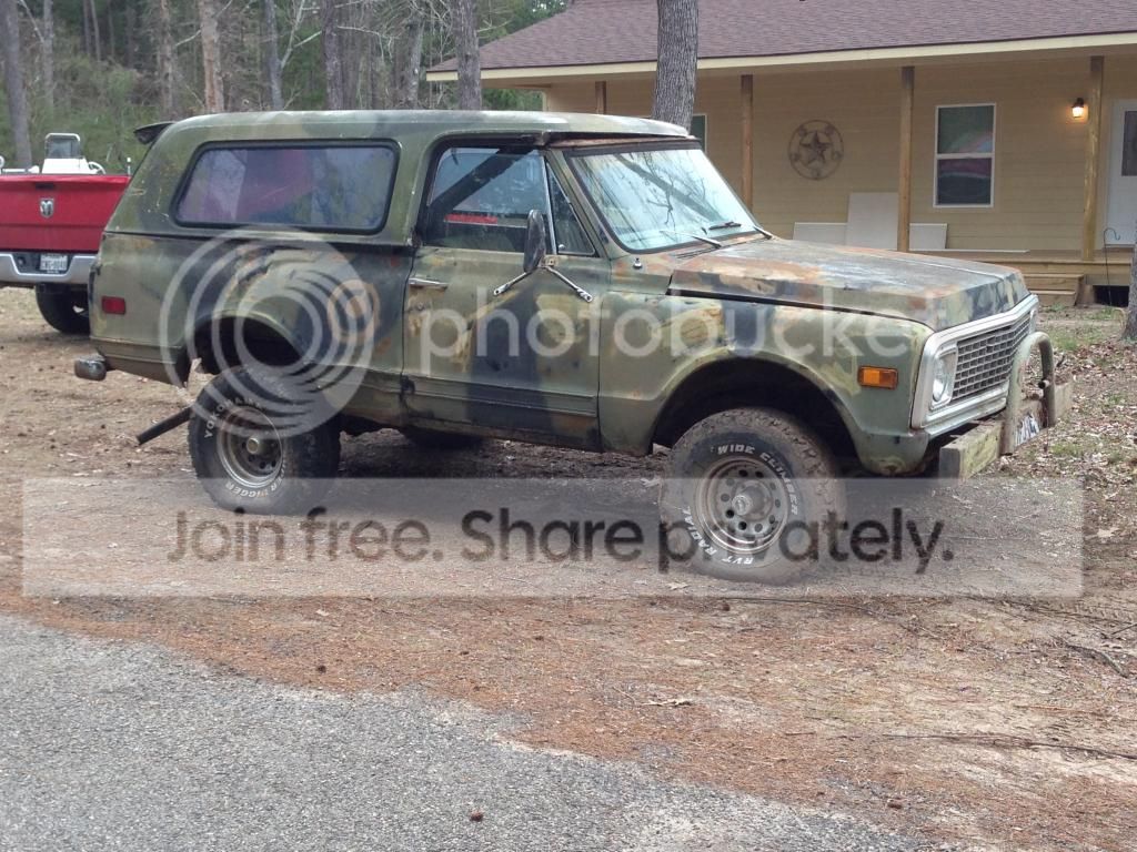

I have a question on Parts compatibility.
It looks as though all interior / Dash parts should be interchangeable. Is the AC system, Radiator, Grill, front bumper, hood, engine components.
Could you guys with more experience answer this.. ?
Thank you.

Thanks for the link. Just had new garage built and now have a place to work on 71..
