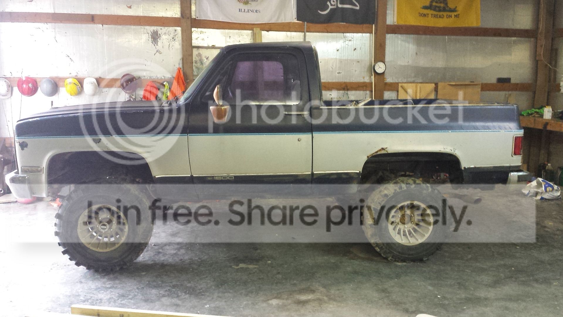

You wouldn't say that if you seen what it looks like under the hood and in the cab. She currently isn't running. The fuel tank is out, the guy had a boat gas tank in the back running this thing for some reason. I think because he switched it to carb and couldn't figure out how to use the internal fuel pump. Not sure. This is my first build... ever.
Looks clean rust wise, doesn't look to bad if all you have to do if swap back to TBI and fix the fuel system.
I hate when ppl do that. Usually why I just stick to carbed trucks. Can build a new harness pretty easily if need be, but I had an 88 that was TBI and I miss that thing...

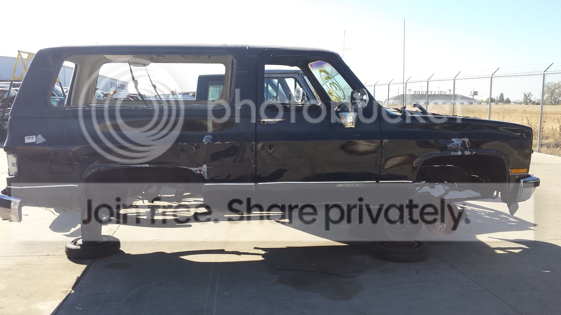

Hey 76k5blazerr, you said if I found a square body burb or blazer at a pick and pull yard to take a picture. well here it is. 1990 k5. It's been rip shagged. No harness or throttle body. but the top is in great shape with seat belts built in.
