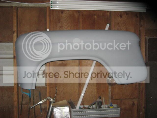

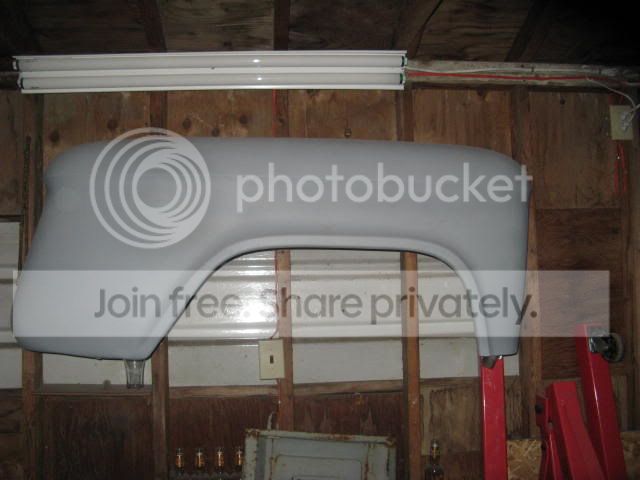

Snapped a pic of each fender...but grey primer isn't very photogenic.
passenger fender.
Driver's fender
Rene
Those look good Rene. I am enjoying learning more about what is coming up in getting my Blazer ready for paint.
90% seems to be the norm, lol. Think those fenders turned out real good. I take it you are using the pink Bondo? The type of putty will definitely make a difference. I'm playing with that now. I just switched to Duraglas, and I think it will be a way better product. Fibreglass impregnated, waterproof, but think it will last a lot longer. Will take a little different technique to shape it since it dries harder.
