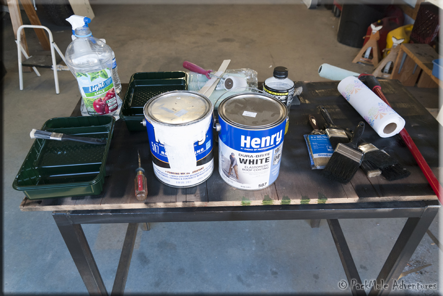

Supplies:
1 Gallon Henrys 587 Roof top coating White ($27.97 at my locla Home depot)
(2) 1" paint brushes
(2) 3" paint brushes
2" wide painters tape
Small disposable paint tray

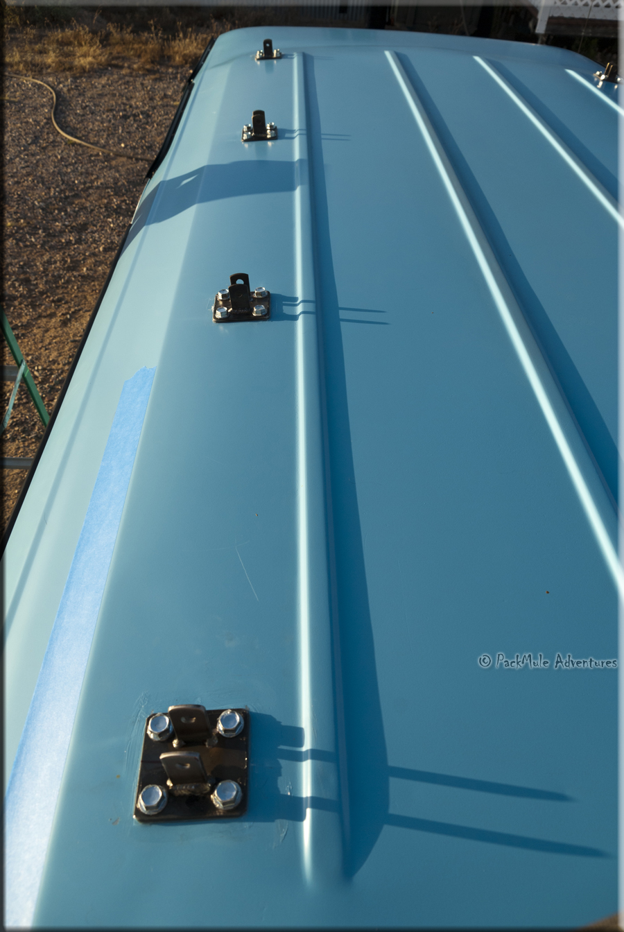

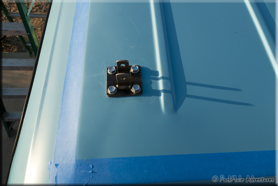

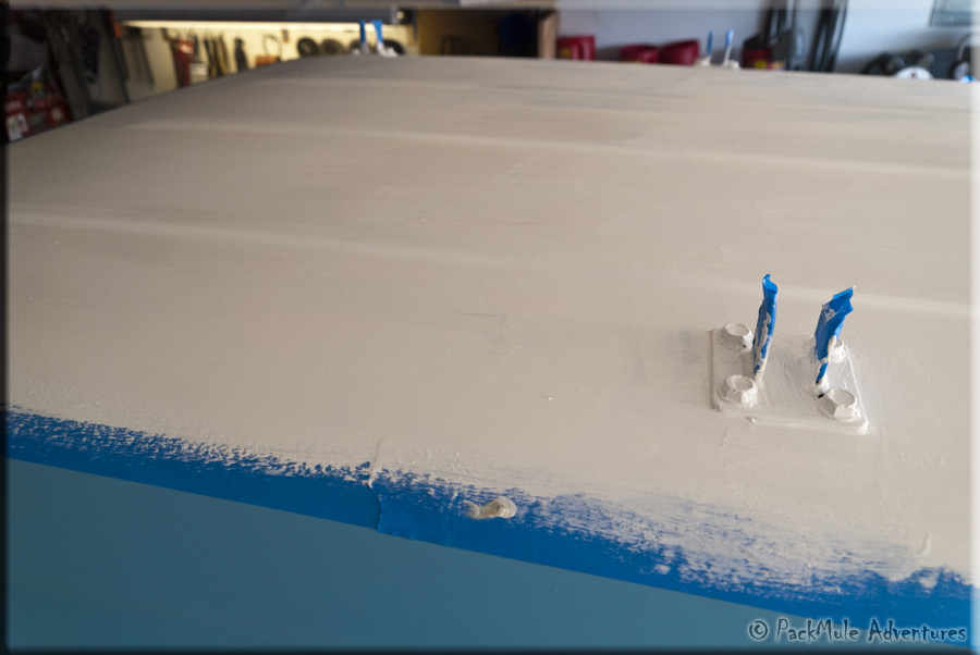

First wash and degrease your roof. It needs to be clean like you are getting ready to do regualr paint. Tape off where you want the edge of the cool coat to end. This is strictly personal preference I chose to follow existing body lines. It also helps to keep a straight line when taping.
(Sorry the blue tape blends in with the paint).
Now take either a green scotchbrite or some 320 automotive sandpaper and scuff up the surface. Once thats done take a damp towel and wipe off the sanding dust.

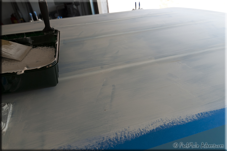

When you open the paint make sure you mix it will it may have seperated while sitting on the shelf. Once mixed it will have a consistency of Chocolate pudding.
Typically it will take 3 coats to get good coverage.
First coat

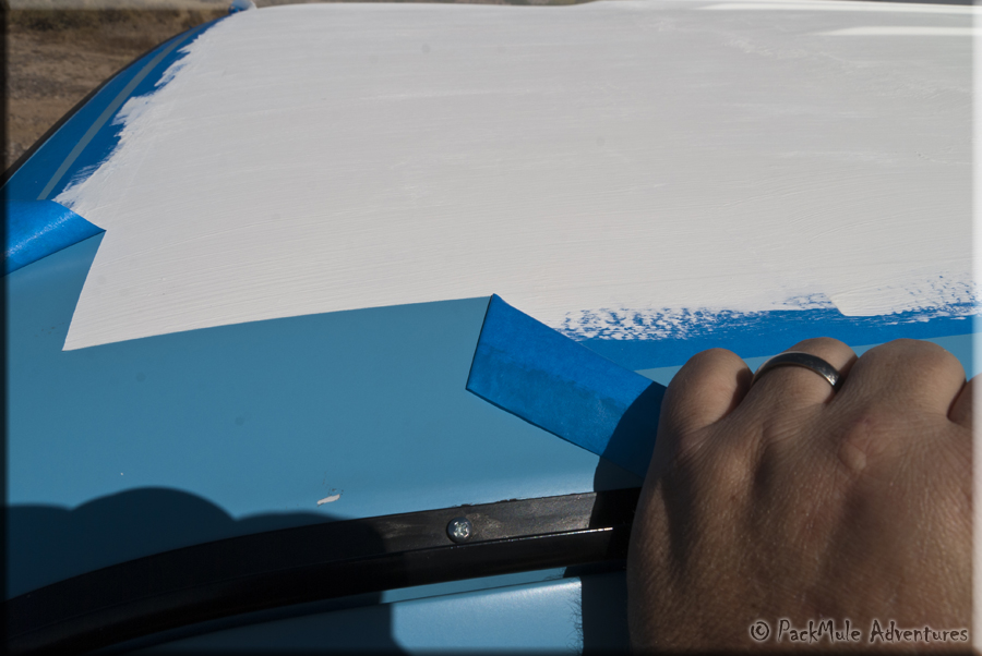

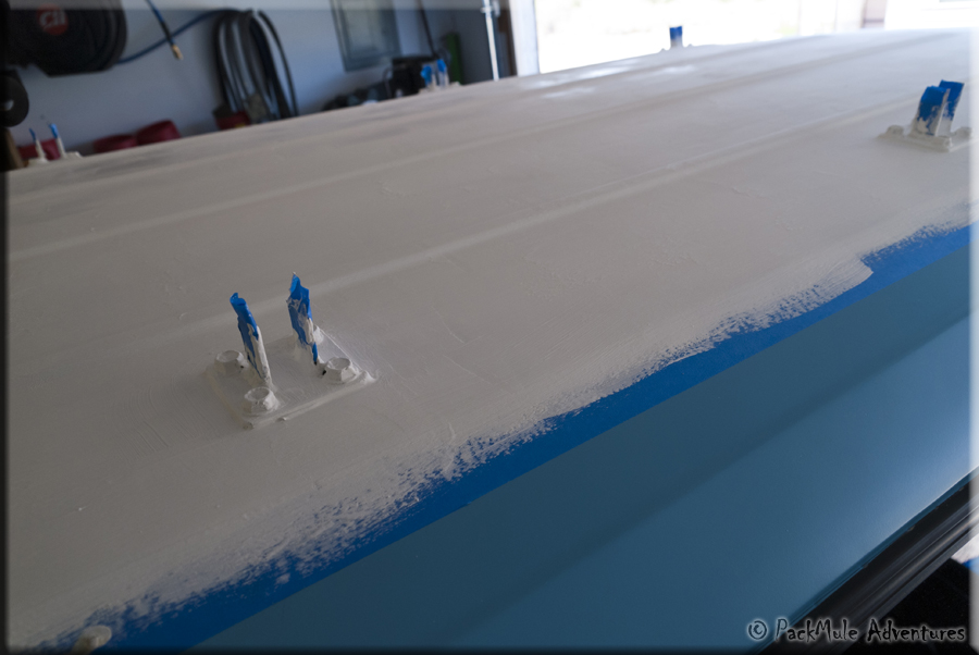

Second coat, change direction 90 degress and go against the first coat's grain. This helps evening and sealing.

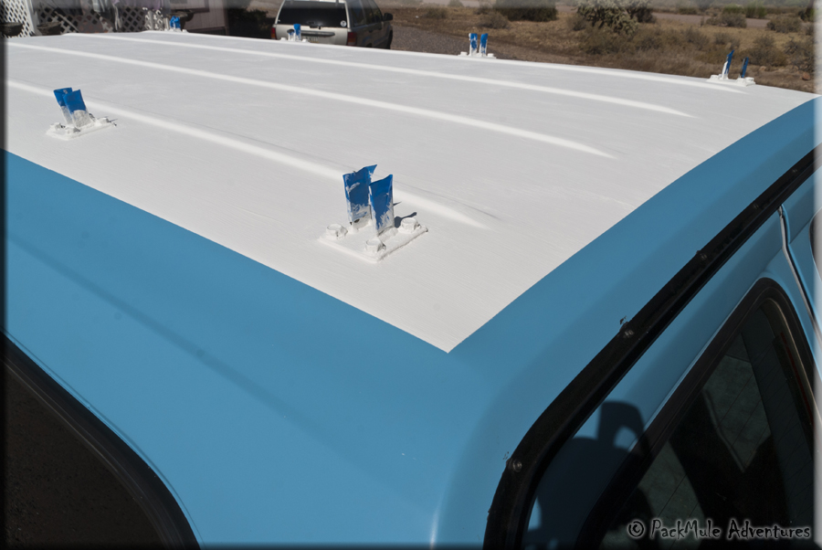

3rd and finally coat, again change brushing 90*. I started front to back then side to side then finished front to back.
Being that we hit 100* today already I only had to wait about 15 minutes between coats and about 2 hours for full cure.
When you go to remove the tape you almost need to pull it directly back on its self. this helps "cut" the paint and keeps a clean line.

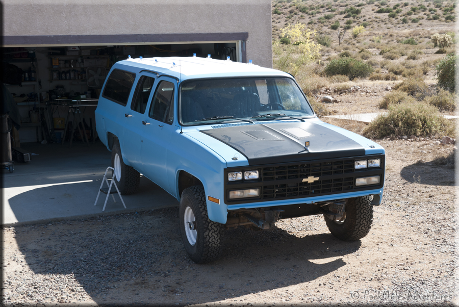

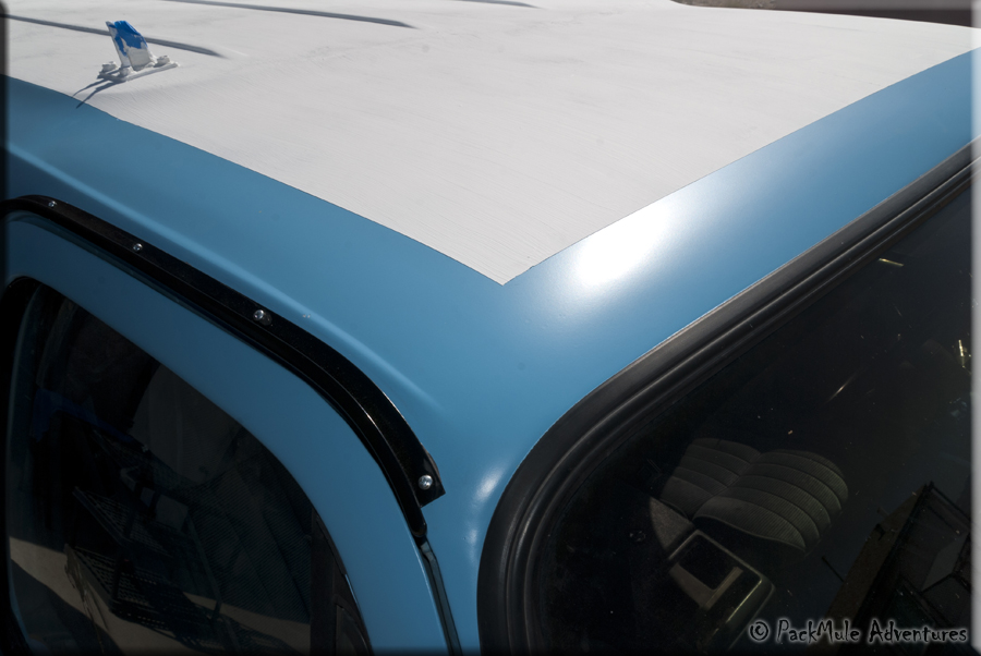

Finished!
Now enjoy nice cooler summer days in your vehicle. This will also help when you leave it parked in the sun all day it wont be as bad when you first get into it. You won't have to worry about redoing this for years to come.
