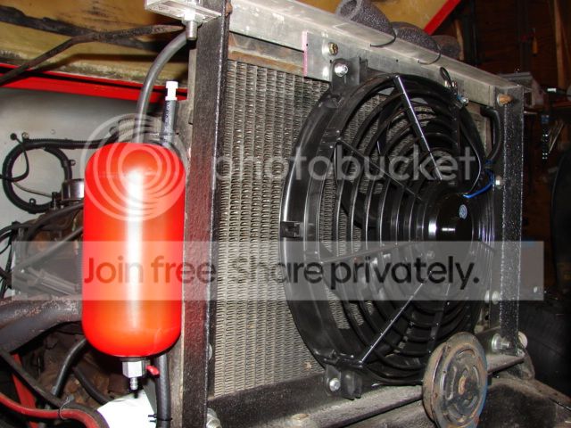

800ml is a little bigger than a Vodka bottle (yes, that's how I compare metric volumes) and would probably be big enough. I just need to have at least some coolant in the bottom when it's cold and have enough room for expansion. I don't think it rises that much in my bottle now, so I might give this one a try.

Is one quart going to be big enough? I'm looking at that Jaz container, thinking how I'm going to mount 4" diameter to the core support. I wonder what my left over PSC reservoir mount diameter is.
