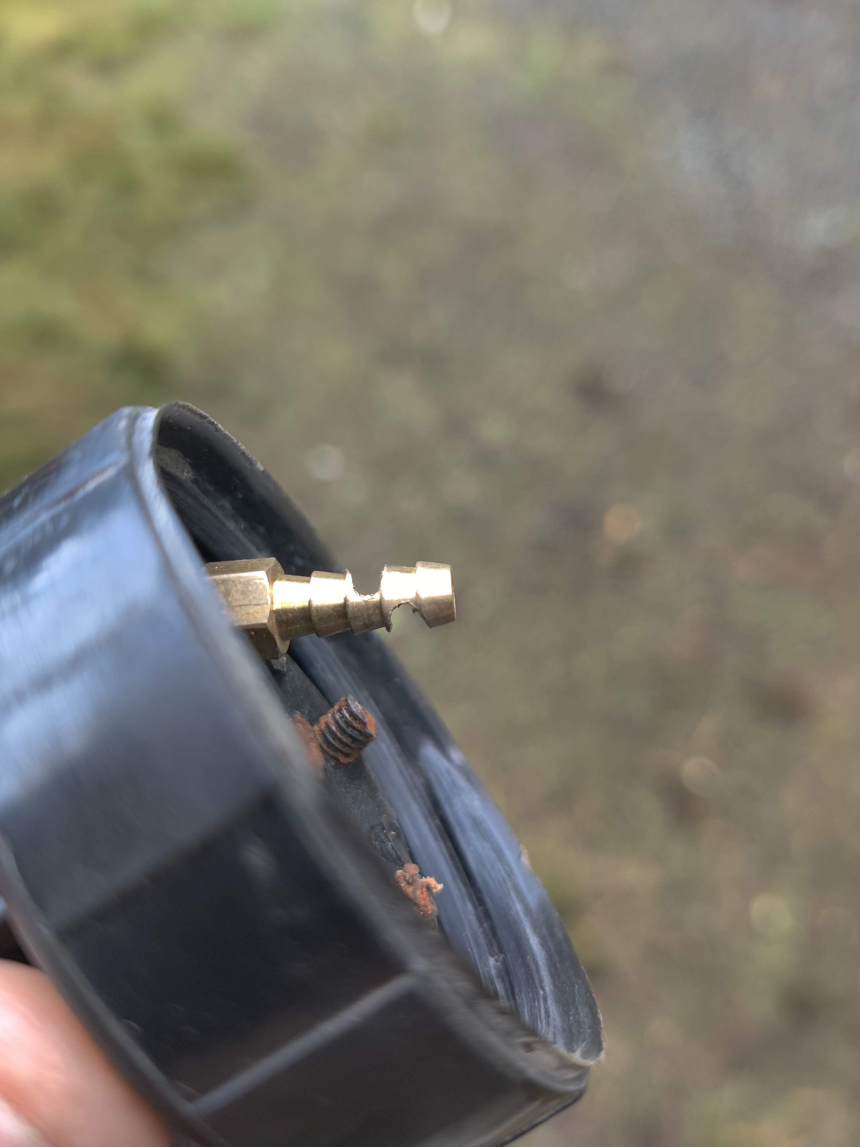

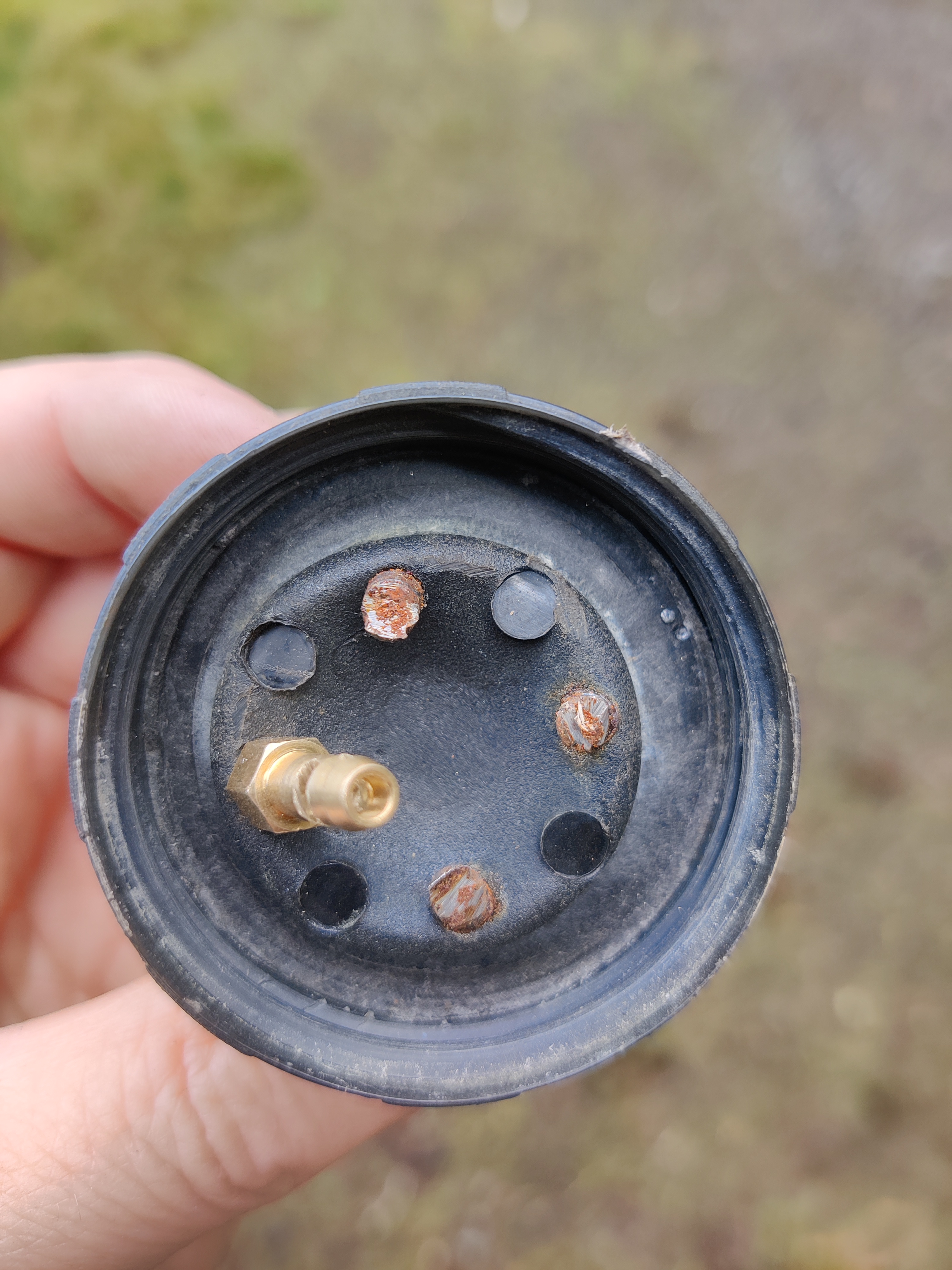

What I tried first. It helped, but still lost a bit of coolant:
full
10-32 threads, just pushed it through the existing hole:
full

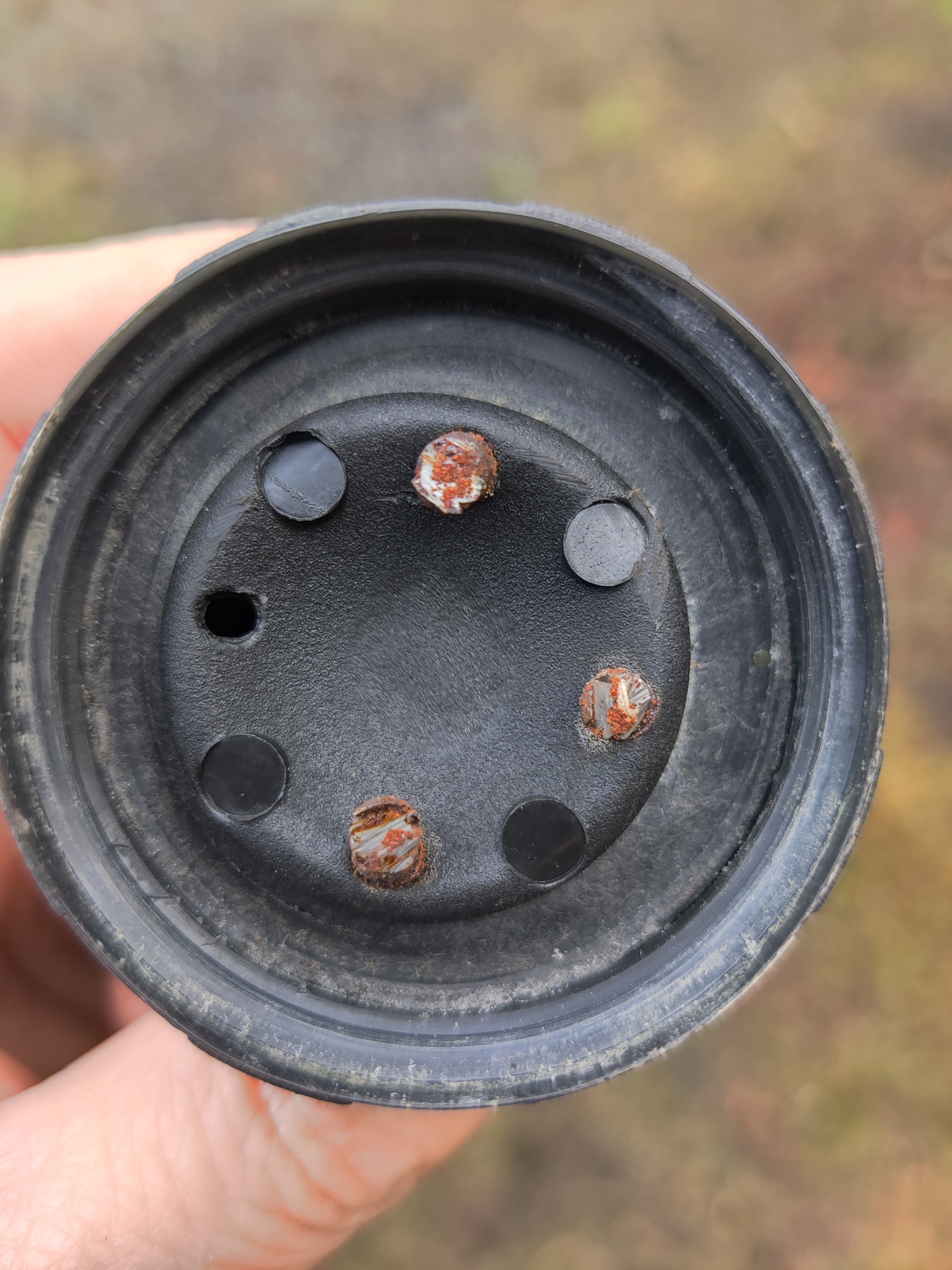

I *think* the added slots will help make sure coolant can't flow easily if it does splash just right:
full

The new "nozzle" vent seemed to work good. Good enough that on a random check I noticed the remainder of fluid that leaks is getting past the gasket on the cap. I'm using what GM did, a thin paper(?) gasket. Even though I block sanded the mating surface flat, there is some sort of sealing that isn't happening. Probably just need a thicker, slightly softer gasket that will allow for a snug cap, but able to conform better to whatever isn't sealing right. Not sure what material that would be, but I'll have to figure it out to try.

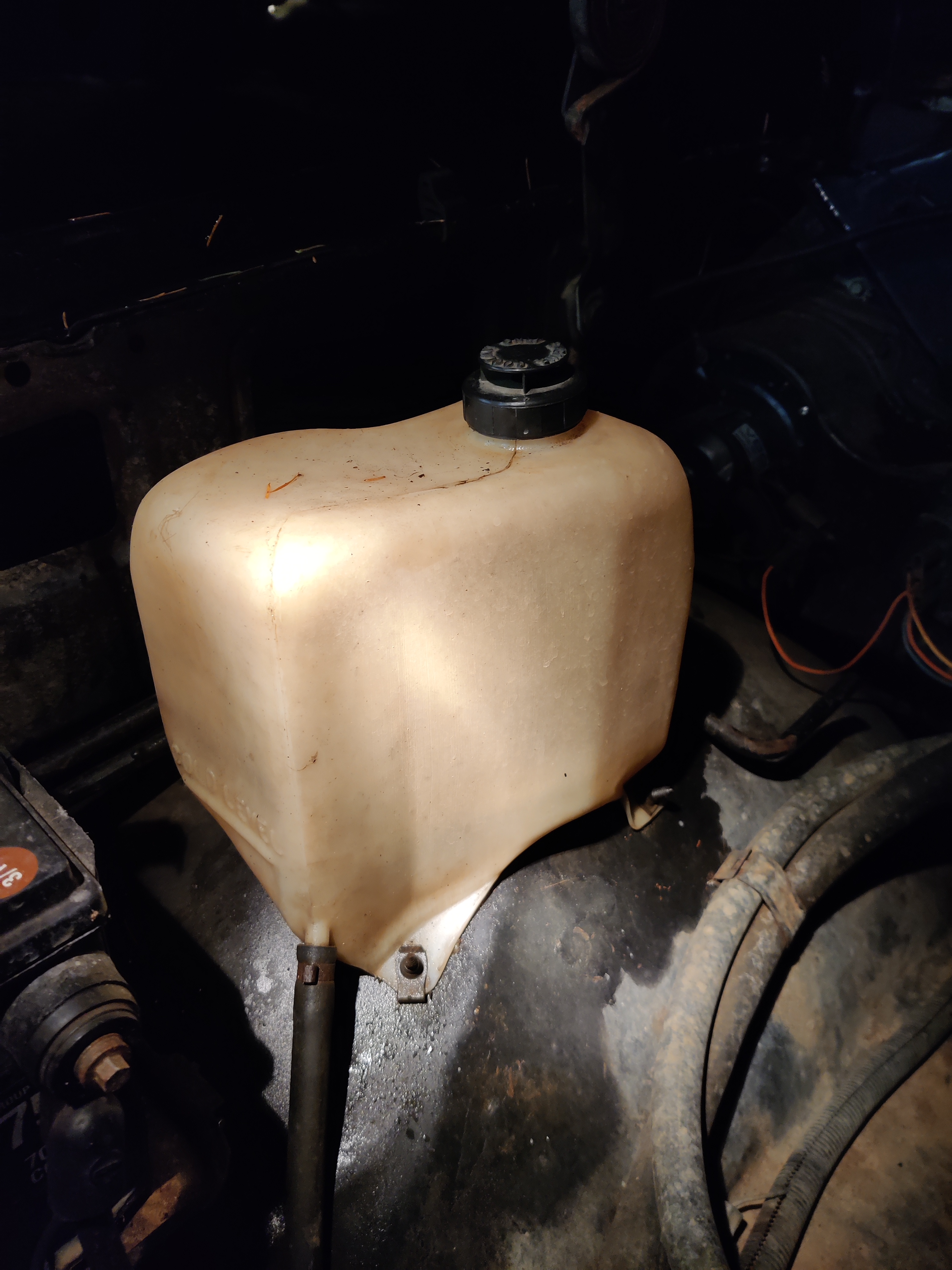

Here's what it looks like after six days of bouncing around:
full
If you look close you can see the fill level is at the cold mark, so it's not like it loses a ton of coolant, but I hate leaks, period.
are you sure your jug is not cracked? Had that happen before...
Guess the question is did your modification substantially reduce the ejected fluid or was it a small change?
Was that a new cap and gasket?
Seem to remember you saying you used a paper gasket. Have you tried a rubber gasket or non-hardening sealant around the cap gasket?
As mentioned, cracks, especially in the seams are common. I replaced two tanks over time. I couldn't find one crack on upper seam until I removed the tank, removed the cap and placed a cover/stop in its place, then turned the tank upside down and added coolant thru the overflow hole and let it sit upside down. I found the crack/fluid leaking out half way up the seam. Might be worth a check but it sure looks like the cap is not properly sealing around the threads.
I'll just answer all here.
I don't think the tank is cracked. I cleaned it all up initially, and happened to check it after doing a bit of off-pavement driving. The only spot that was wet was around the fill cap. The way the inner fender is wet after far more driving, and what I saw on the tank, indicates it was on top of the tank and ran down the sides. I've never seen evidence of a leak after long periods of it sitting either. But it's going back to storage so maybe I'll clean it up again and verify.
If it isn't a leak, I assume others either don't hit that many potholes that often for that long, and/or the cap just isn't sealing right. I am using a paper type gasket on it. I have no problem trying a different material, but I think it would need to be something soft so the cap doesn't need to be cranked down very hard. I'm not really sure what material is up to that task.
The modification did seem to make a difference, I lost very little coolant this season, normally the overflow would be empty.
The picture makes it look like the cap is dry, implying a leak around the threads. Maybe a flat rubber seal like from a gas can would work.
I suppose it's possible I don't notice a leak because things get wet from wheeling anyway, but I don't think I've added coolant this year and I just checked it a couple days ago.
I agree, a thin rubber gasket you can make from an inner-tube or ?? or you can try a small amount of non-hardening gasket sealant (permatex, Loctite) on the top lip of the tank so when the cap is cinched down, its sealed. This will at least verify if the cap/threads is leaking which is what it appears.
