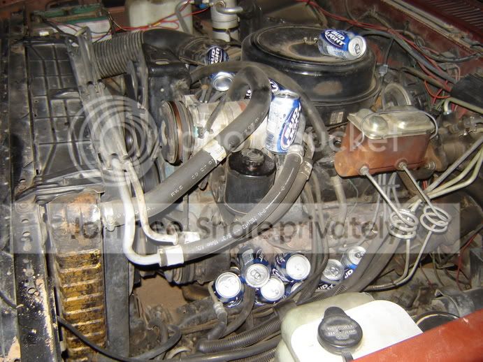

ok I was looking through some old pictures and heres a pic of the 4 core bracket. This is on my K30 and everything is stock, except for the beer.:wink1: But in the pic you can see the shoud, and the how the bracket is different, but it will bolt up with no problems. :D
