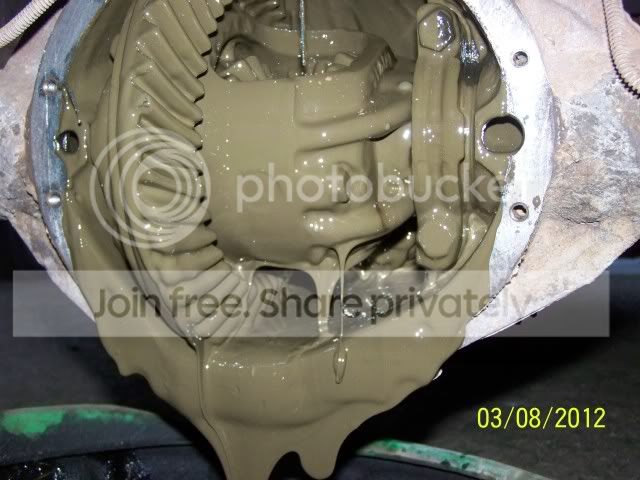

Some insight on this is highly needed,My wife's 79 k5 came with a 12bolt rear end,Well the pinion bearing is shot due to the PO's lack/non service of the diffs after mudding at the local hole and 6 mnths later I buy it as a dd/wifes truck and we are haveing a issue with the rear axel and have a 10 bolt out of another truck but has no brakes and was wondering what parts i can change without having to spend alot on a bandage till I can find a 14blt for it,????Some photos of the mud I drained out of the rear and it took 27hrs to drain..
[/IMG]
SO if you can give me some info-links it would be highly appreciated:bow:

Well the pinion bearing is shot due to the PO's lack/non service of the diffs after mudding at the local hole and 6 mnths later I buy it ...
So was this axle being driven on for 6 months with that mud in there? It looks like it sat in the hole for 6 months. Everything sounded OK?
I am not sure how long they drove on it,But when I put new fluid in it and drove it had a whine/growl so we have swapped in a 10blt gbomb with the fly weights tied shut and are currently hunting down a 14blt and some new chairs.
