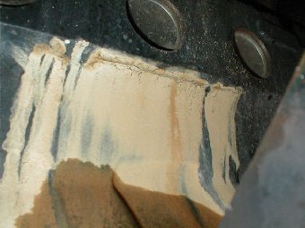

I think 98.5-2000 models can potentially have the 53's. They have a weak spot in the block. It starts to crack in the side of the block near a coolant jacket and will leak coolant.
53 block cracks on the passenger side about #5 cylinder in the radius below the freeze plugs.
