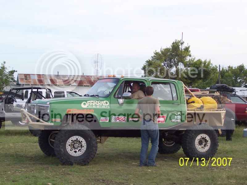

so i got my most recent issue of 4wheeloffroad....and ORD took cousin willard on the ultimate adventure...anyone know the build up there...thats a great truck more pics?

4-link front, 63 rears.
Looks to be like they were running the new 39"(?) MT's
Crew cab with flat bed out back. 454 to a 4l80e transmission with controller to a gm 203 to ford 205 doubler. The front is a HP ford dana 60 and the rear is your standard 14 bolt. The front is their new coilover 4-link kit and the rear runs 63" springs with a long version of their traction bar. The wheels are the new trailready trophy truck wheels and the tires are the new MT's either 39 or 42. The steering is all PSC with hydro assist. The front bumper is their new low profile winch bumper. Anything else?????
