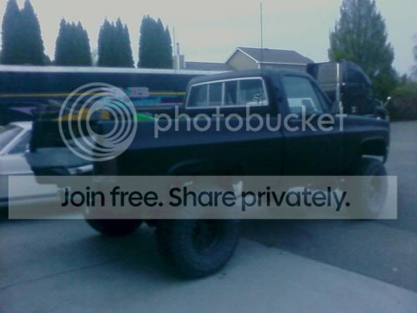

4' lift, 35x13.5x15 toyo mts, 15x10 wheel w/ 4" backspace
Sorry about the crappy pic. its an old cell phone pic
