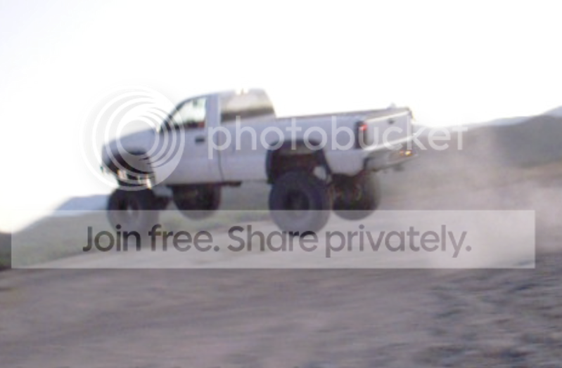

ive been beating mine to death, ramming things, bashing into it, hitting the tie rod till it smiles, turning into ledges while bouncing around and flooring it.. killing it!..not a drip of fluid and bolts are tight, I can live with that. Considering the casting of that housing is what the carrier its self and load is held in place by..I think its fine and more than strong enough.
