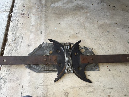

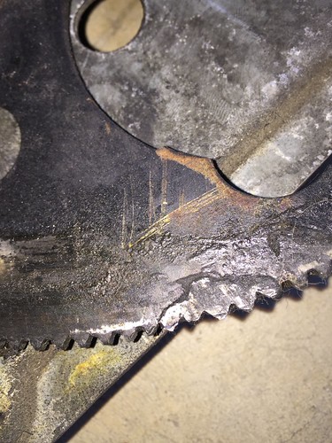

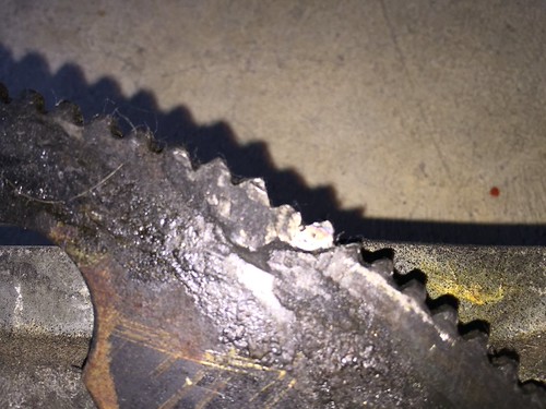

I think I found the cause
I took the panel off the rear door, disconnected the window sash from the regulator and pulled the regulator assembly out. Upon initial inspection everything looked in order, so i decided to roll it roll it all the way to the down position and BOOM! Found the problem... i think. Lol.
It looks like a few teeth are stripped out on the driver side arm in the nearly closed position. I think this is what is causing the skipping. See pics below.
