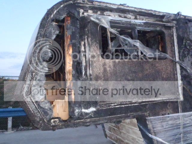

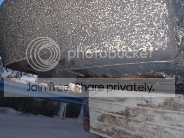

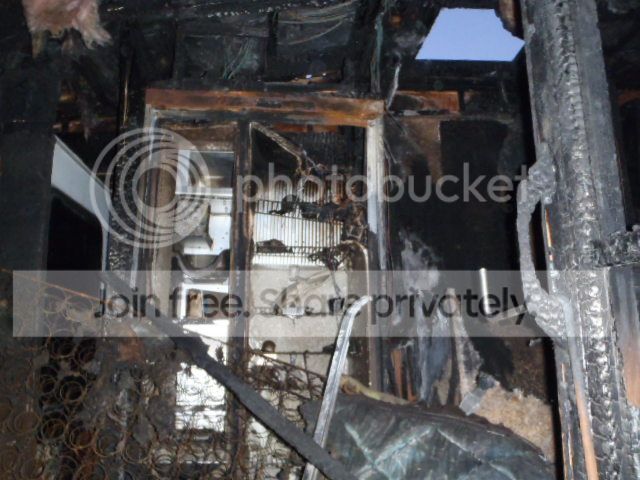

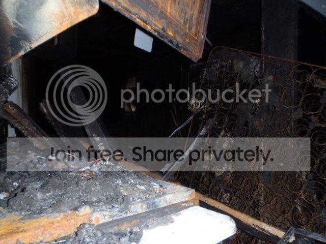

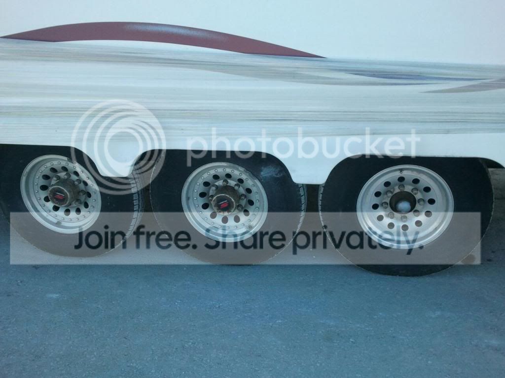

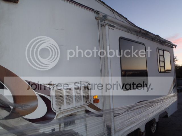

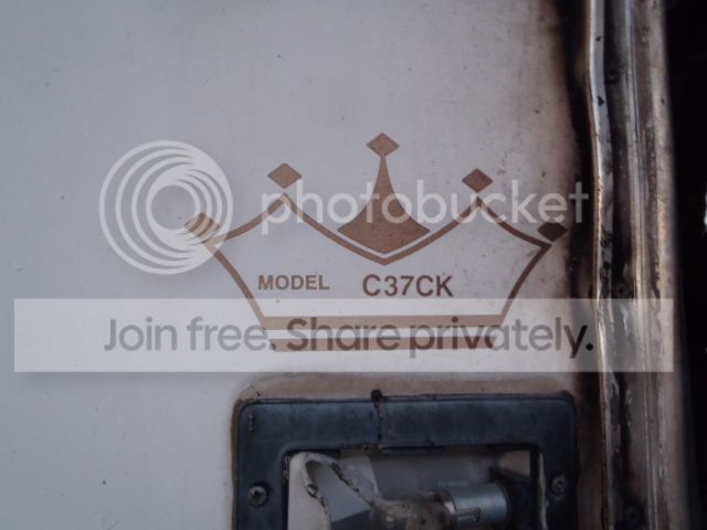

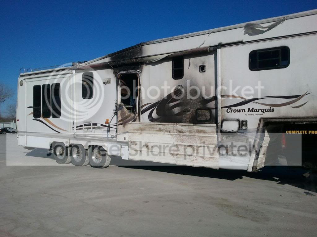

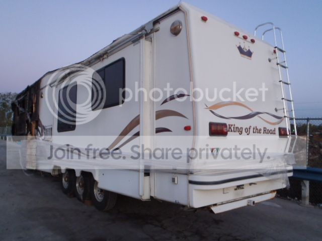

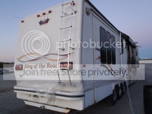

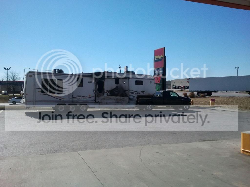

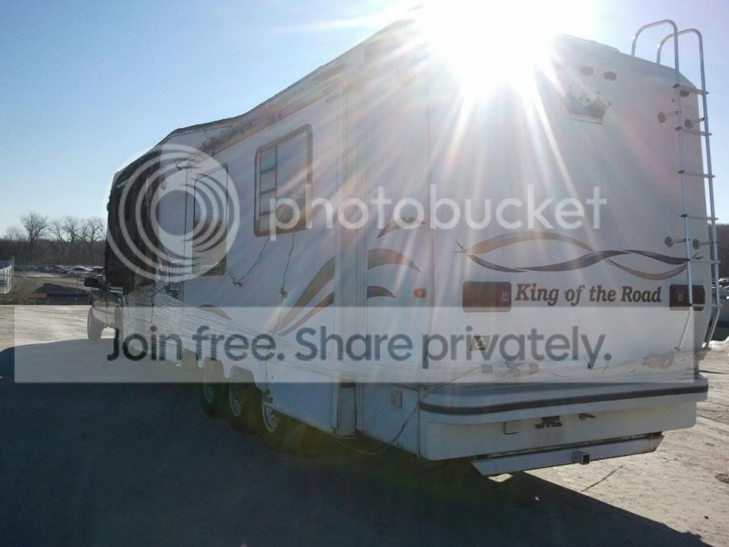

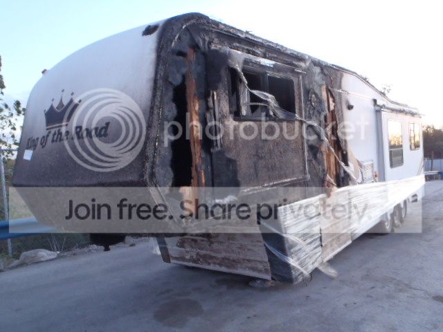

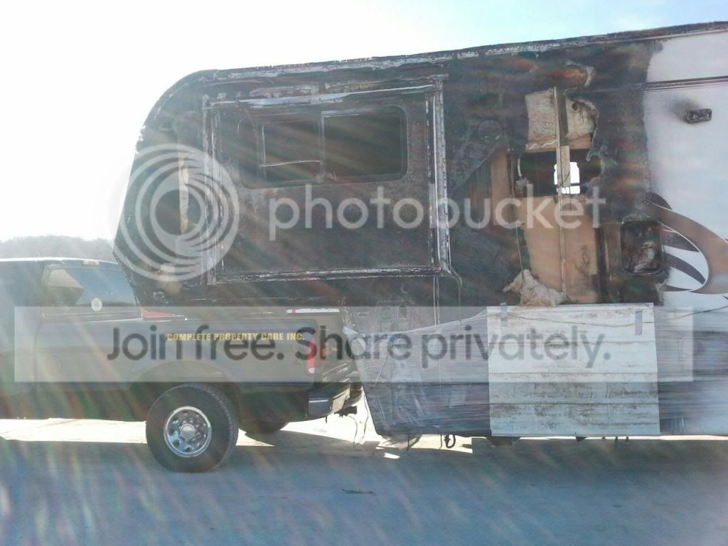

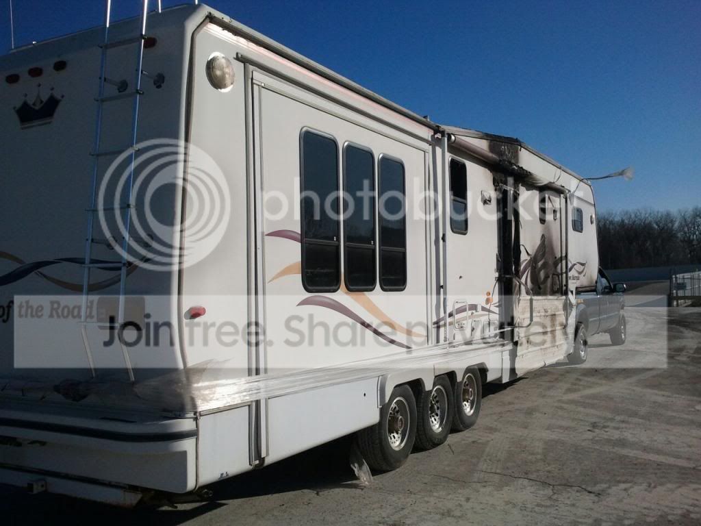

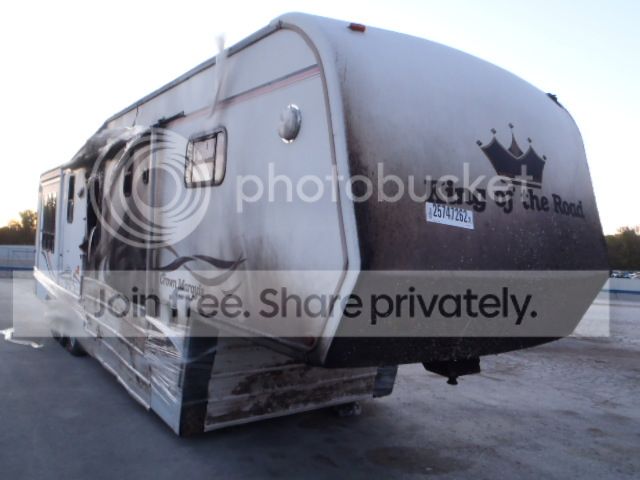

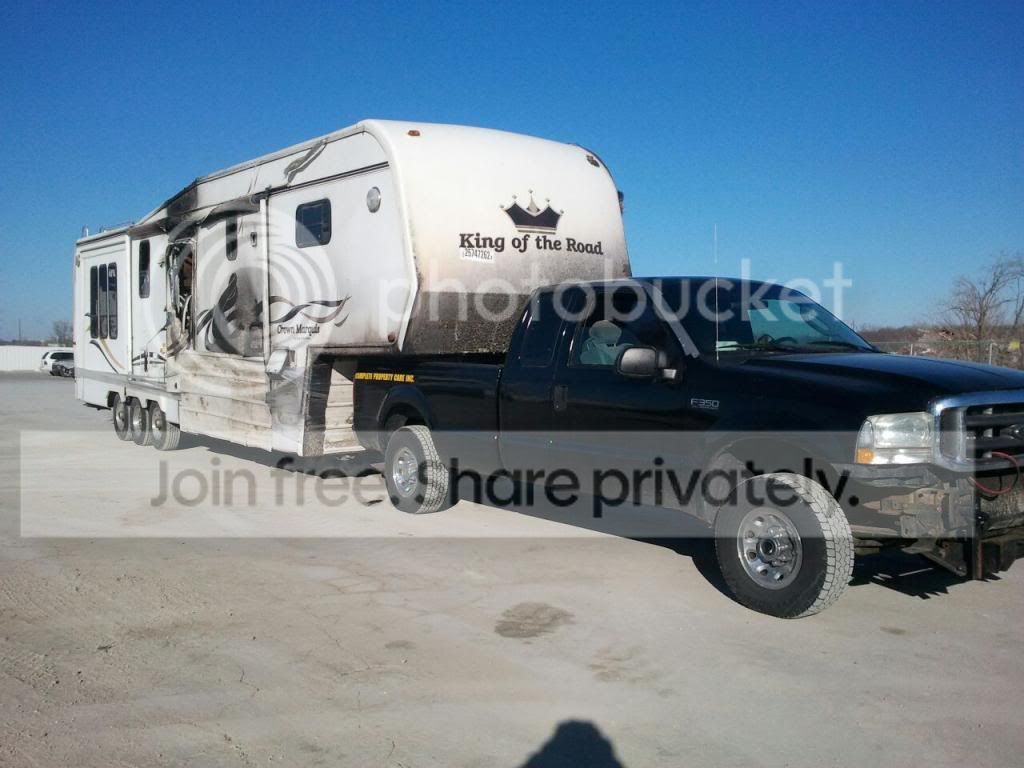

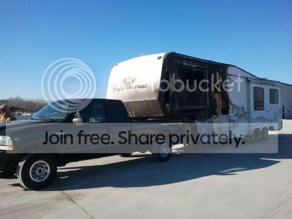

just went and picked this up today. took me 17 hours when it was supposed to take 10 due to a tire locking up and me tearing into brakes in a gas station parking lot haha. paid 360 dollars after the auction fees. its a 37' 11" trailer that I want to be able to haul 3 vehicles when is all done, heres the start, this build may be slow but ill update as we get things done.
thanks for looking, ENJOY!
Auction pics
Do you know what the fire was caused from? I've heard of a lot of buses/RV's catching fire due to the water heaters. I guess thats not a bad idea for getting a good sized flat bed on the cheap.

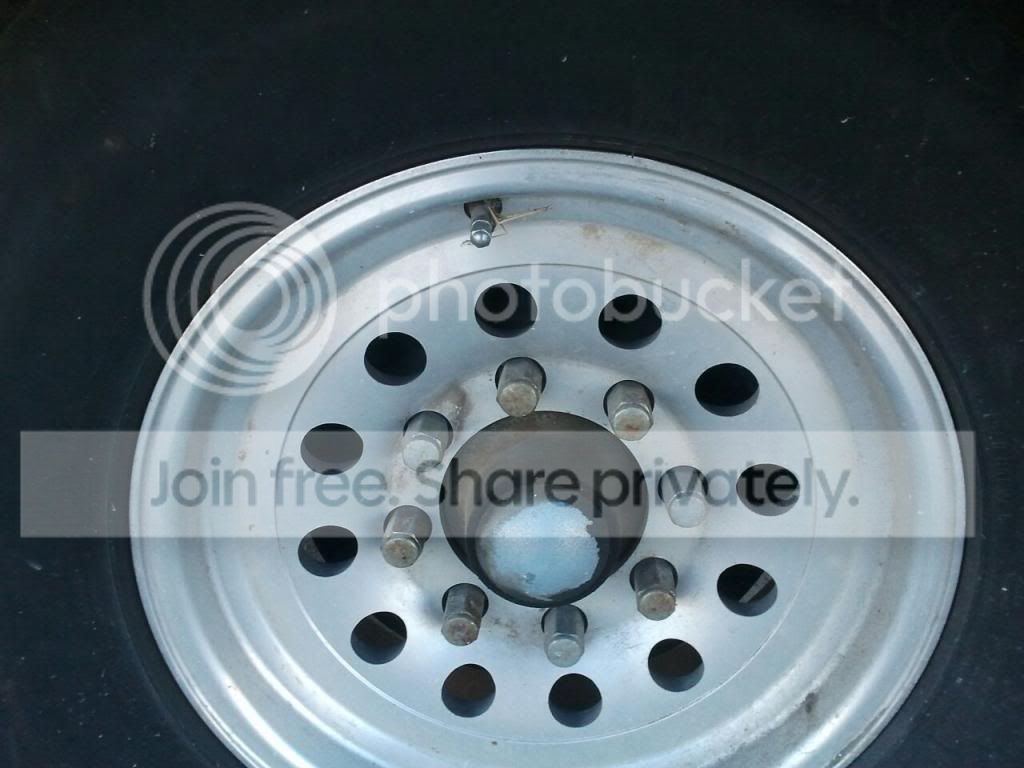

You couldn't get the axles wheel and tires for 360 bucks at all. Not even close.

ive heard that too. but the frame looks like 10" I-beam. I don't know yet though. I have steel and plan on reinforcing quite a bit anyways.

Looks like the one down the road from me. Sat Burnt outside for almost a year. I had the same idea. My current car hauler was a 22 foot nomad camping trailer. Now it's a 18 foot car trailer and I get compliments on it all the time. I bought the camper for 200 from my dad and have about 400 into it in wood, steel and tires. In to see how this turns out as I would like to have a 36 footer as well.
Gonna convert to gooseneck or leave it fifth wheel?
Camper trailers are not set up to handle heavy loads. They are built to have the load distributed evenly across the whole span. My dad wanted to convert a 5th wheel camper to a car hauler a few years ago, I looked at it and told him no. I have owned several campers from old to new. The cross braces are to far apart and are usually flimsy. Most of the time they sit hi which means the deck height of your trailer would be high, for off road vehicles it wouldn't be so bad. In my opinion they don't make good car haulers with that being said I am converting our old bumper pull camper into a flatbed utility trailer. It is only 16 feet long and I am still having to add a lot of supports for strength. We had a 25 foot bumper pull camper that we bought brand new in 2008 within two years the frame was cracking in several places and we traded it in. I think if you look at a well built flatbed trailer then look and compare the structure to a camper you would agree. Just my input, I've seen some scary set ups on the road.
