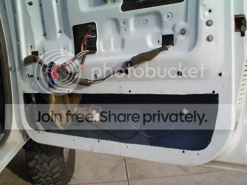

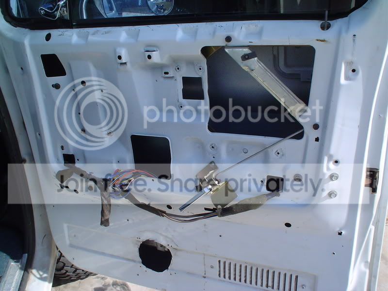

Here's my door before I cut it up and put the diamond plate aluminum in. You can see what the door looked like before and after I cut it. And, you can see where the power window motor sits.

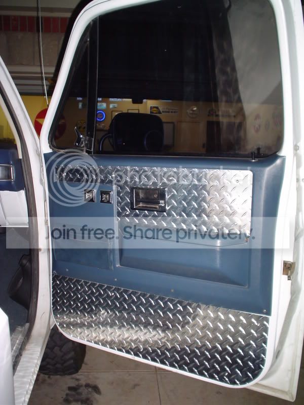

And, here's what I ended up doing just if you were wondering.

Great pictures! 'Specially the one showing the window motor. Looks like I'm gonna have to get creative with speaker mounting.
The diamond plate looks great too. My door panels are in decent shape, so I think I'm just gonna keep them. But if for any reason I decide to do something different, I just might plagiarize the **** out of that idea. ;)
