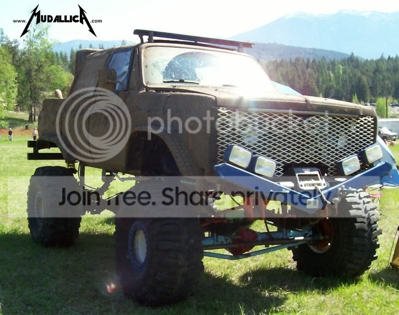

Theres a guy, Dennis, who goes to a local mud bog up near me every year, and he was also in Top Truck Challenge a few years back, and his, if I remember right, was on a K5 frame. You can see how the rear doors had to be trimmed for the fenderwells.
