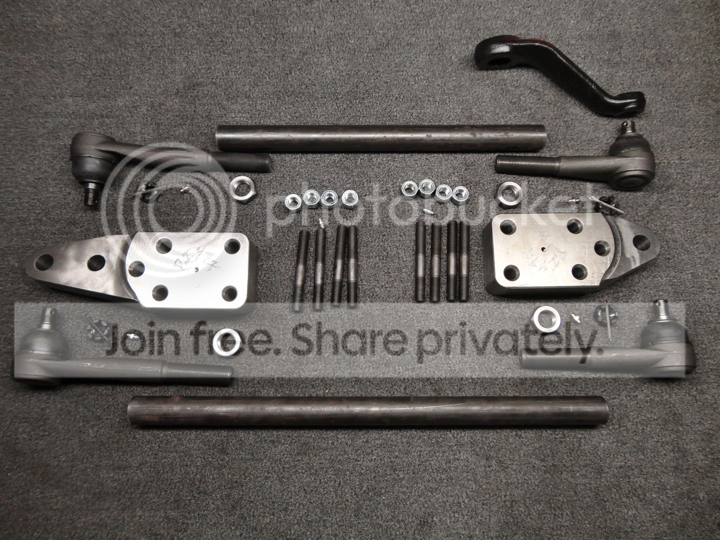

We'll add more options as we complete design on more pieces. More to come.

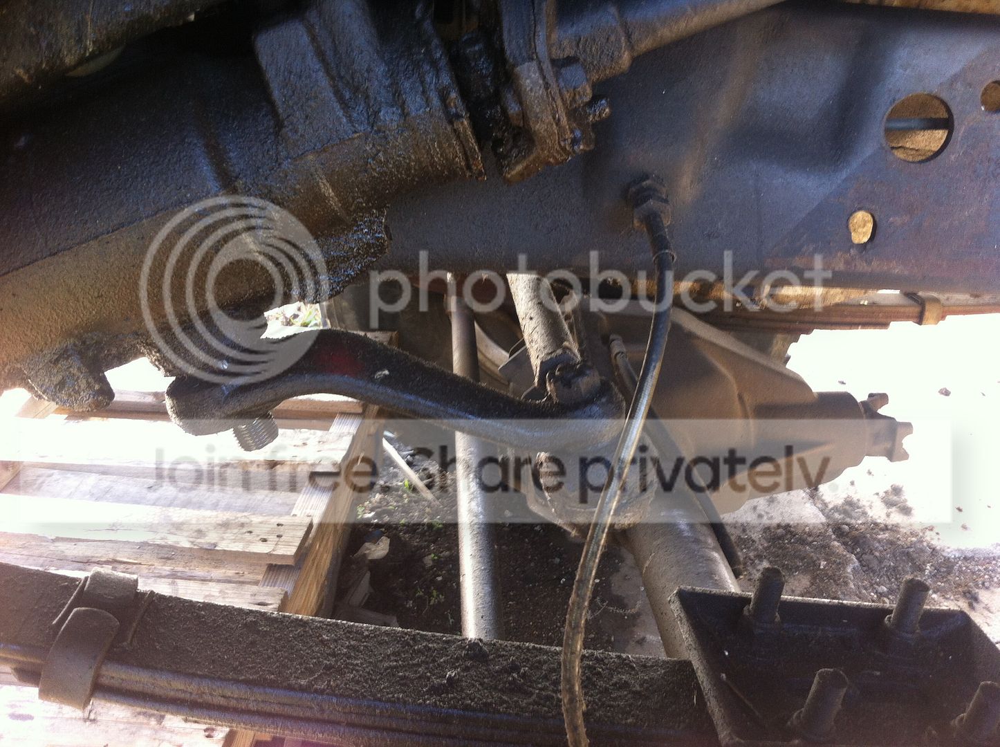

Standard way,

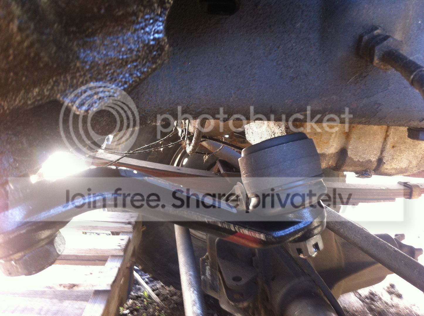

Rereamed and drag link flipped on top.

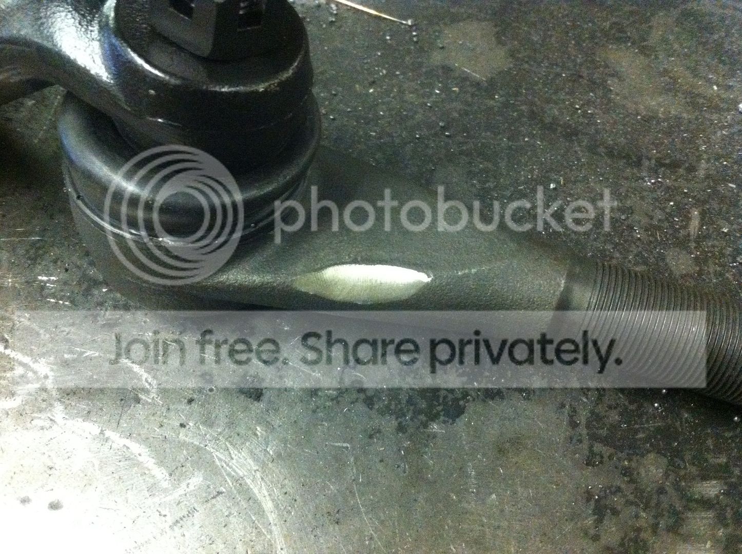

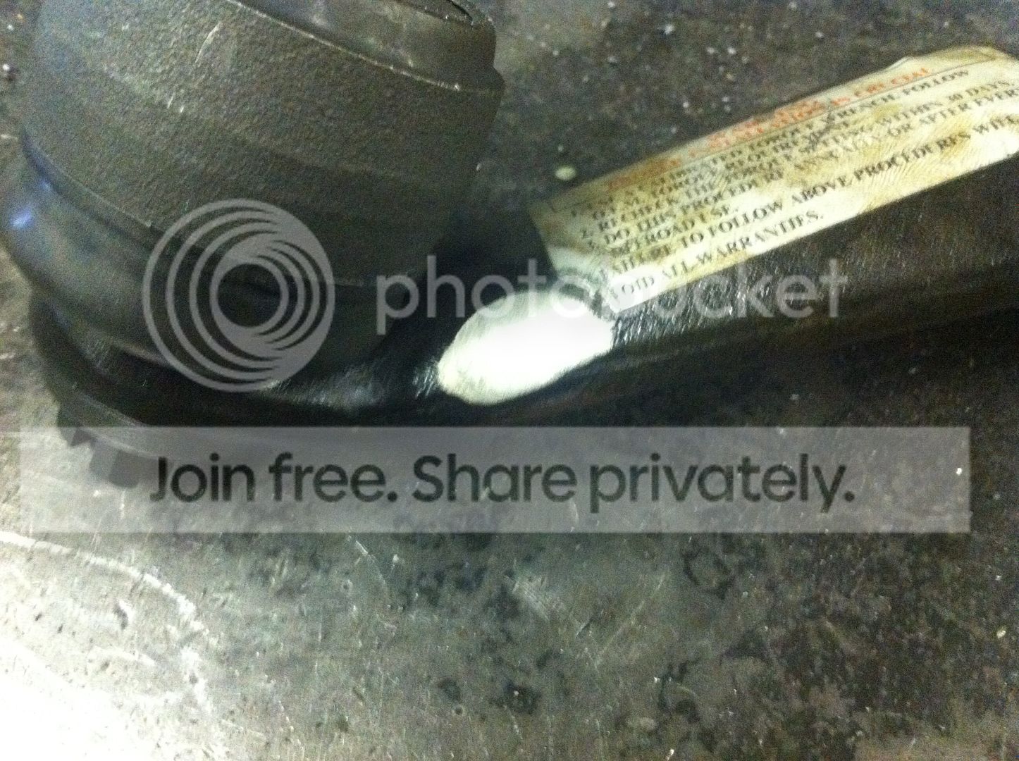

Extreme left turn with the passenger side drooped out, you'd need a little clearancing which we can do for you or you can do it, pretty minor. Just a smidge on each pieces is better than all of it on one piece.
