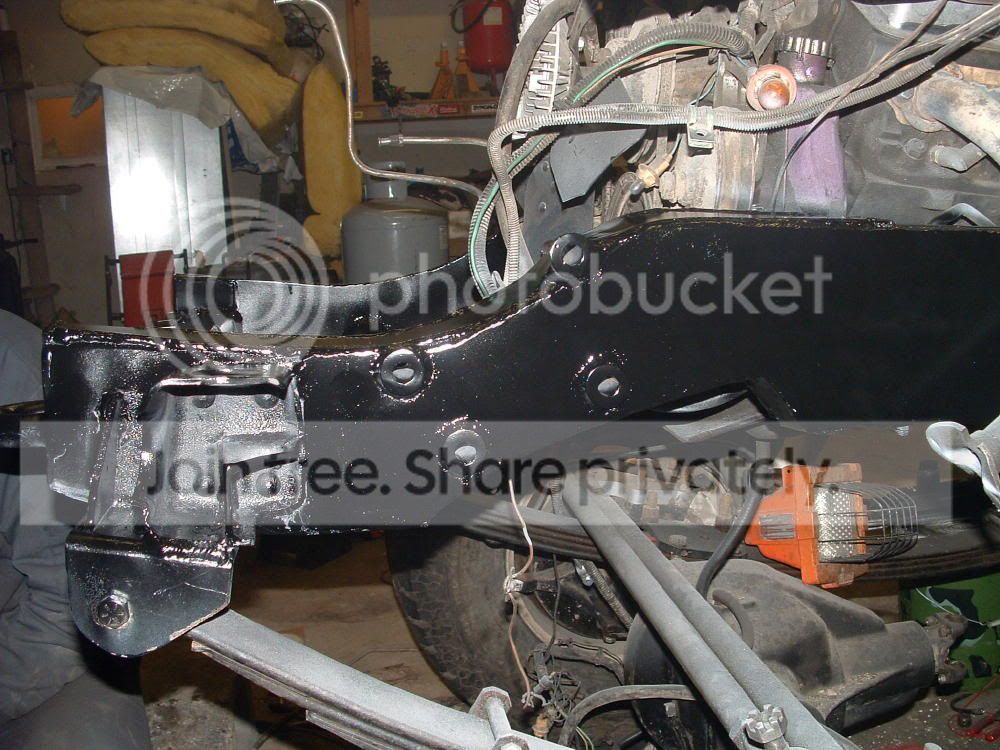

moved mine forward and up here is a pic. With the box installed it set directly on the body mount. The angle required a u joint to be added to the steering shaft. It also hit the radiator so I trimmed it.
