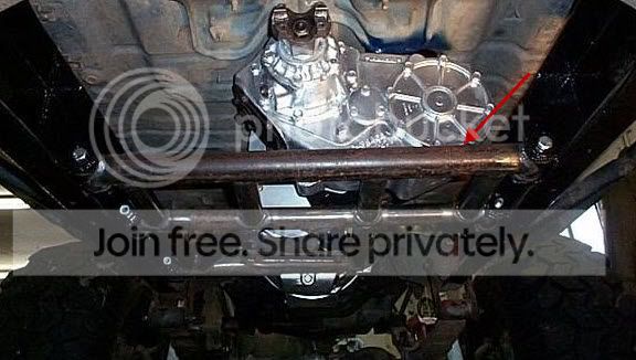

I am currently building a doubler crossmember like the one below. Will have 5 poly mounts to the frame. Also planing on tieing my anti wrap bar to the rear tube where the red arrow is pointing. Will there be an issue with mounting it there while everything is mounted to the frame via poly mounts. Or do I need the make the antiwrap crossmember solid mounted to the frame?
I would say that it would be OK. You are going to have bushings in the anti-wrap bar anyway I assume so the additional flax shouldn't matter. Just make the crossmember nice and stout.
