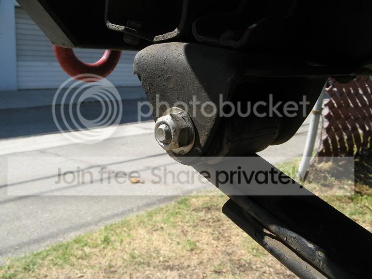

Look at the pics please :bow: There are two questions :D
*Is my draglink far enough away from my leaf springs? Or will this cause problems. Currently there is no weight on the leafs.
Is this bolt ok or should I get something longer? These are the leaf spring eye bolts I got from a member who got them from ORD. Not sure if they belong some other place, just weird they are so short. :dunno:
The draglink should be fine. The spring eye bolt as long as the bolt protrudes beyond the pinch lock of the nut you're fine (looks like it does).

Those ORD bolts are probably for the rear-application 52s/56s that a lot of use run in the front...the stock fronts are 3" wide so the stock brackets you have are probably wider that what ORD was selling those bolts for. As said though, it's probably fine. Just check them in a little while like you're supposed to anyway. If they keep coming loose, obviously they're not gonna be OK.

I checked the draglink, finally. It hits pretty good on full left turn. I haven't driven it yet, but can already see it binding up. The zero rates are a double edge sword. They give me room to run the larger tierod, but screws up clearance for the draglink.
I also need to cut the draglink down 1 1/8 inches. I have too much length to get the steering wheel straight and the tires too match, so one way is full turn and the other is not. I can also run the draglink upside down, since I don't have a stock crossmember to worry about. I will need to get it twisted up however to check for draglink-to-harmonic balancer clearance :haha:
