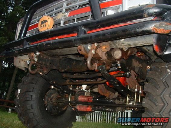

I have crossover and my truck sits at about stock height. The draglink doesn't hit the engine crossmember.
Yeah I think the doglegged drag link works on most set ups but I believe there is enough descrepencies in build 'quality' that some people have a clearance issue.
Sweet. You got one.
Ryoken/Readymix - that is the same crossmamber that I have. Panhard Setup. The vent tube plugs into one from the diff and the other to the extention up. Its really cool because even with some water i the crossmember, the vent gets air at the top.
