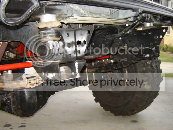

Im actually using kert's b-52 bracket, it left my shackle in the stock location but allows me to move the front hanger backwards or foreward a few inches. Its cool because I can "tune" my shackle angle and use it to locate my axle where I want it to be.
hey, I was looking through my photobucket pics and I have a picture of that front bracket.....

Kert made the bracket over at diy, to be honest they could have fit a little better, but a couple of extra holes needed to be drilled and I was good to go. Let him know if you are going to use poly bushings in the springs because the shoulders on the bushings are a little larger and as a result the bracket needs to be a little larger. Hes a good guy, I talked to him on the phone a couple of times. heres a link to his website. http://diy4x.com/suspension.htm
