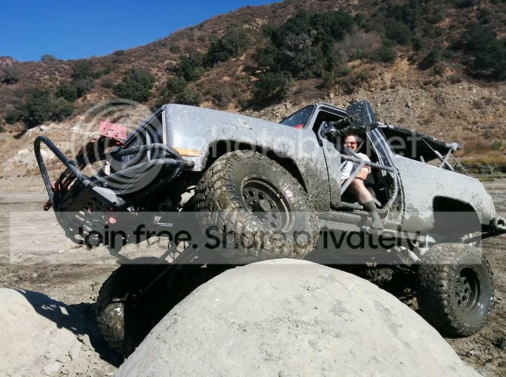

This is the maximum I've ever had the front flexed (Moab had it twisted more, but the rear doesn't mater) The TomWoods 1350 DS doesn't bind and I have yet to find evidence that it has. It is, however, very close. If your front spring flex a lot more than my own, consider a limit strap if the DS does bind.
