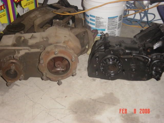

Your best bet would be to buy a complete Getrag/NP205 together, it will be passenger drop like the GM version.
Far as I know, spline counts likely aren't the same between the output on the getrag and any GM trans. I could be wrong though.

This would be correct. The spline count should be 23, but there are some rare versions of the Getrag/NP205 that had a 29 spline input. These appear to be very rare, and would probably translate to some higher dollar value for those who know what they have.
I would agree to get a dodge t-case would be the easiest.
I thought all getrag - 205s were 29 spline male male. as I understood that was the only configuration for the 205 behind the getrag. I got one for $250 from a wrecker in a hick town near the Alberta/ Sask border. he told ne they were rare and still only charged me $250
That is possible, I had always been told that the 29 spline versions were rare. I know that the 23 spline is behind all the auto's, so it is possible that the Getrag 5 speeds all had 29 spline 205's.
I think they kept the same straight through......even the 241 behind my nv4500 is still 29spline 1 1/2" shaft.
I think rare being that its the only application that the 205 was configured like that. Its got the odd bolt on circle adapter for the male/male sleeve.
but with the goofy adapter it'll bolt nice to the back of a NV4500 or getrag.......if you need the Pass side drop use as is. if you need a Driver drop swap 205 input into Ford 205 case and bolt up.
