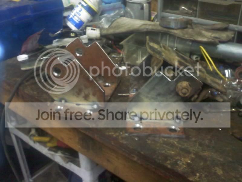

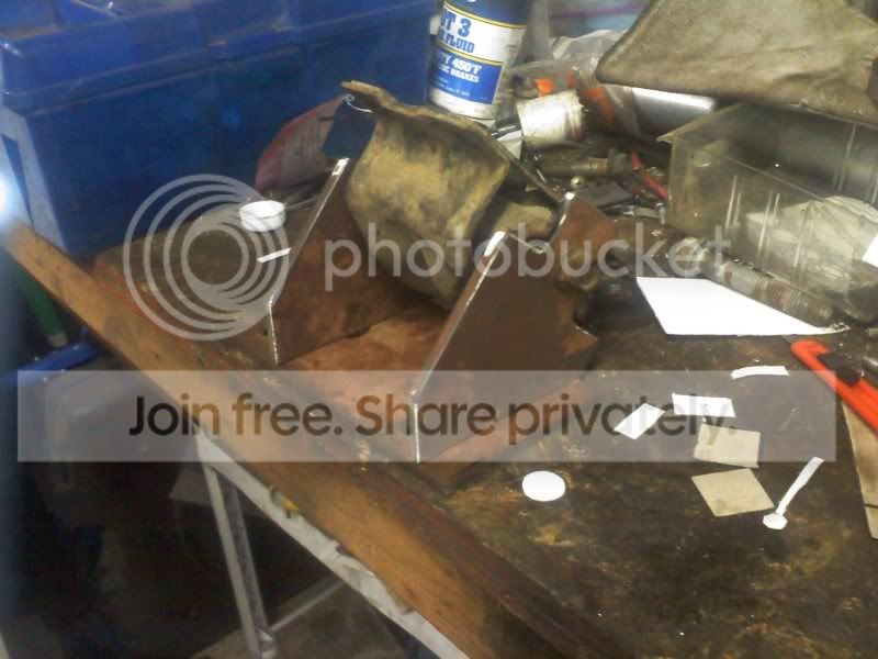

It looks like I have to make my own cummins mounts. I really didn't want to but everything is way over priced for what you get. I'm not sure exactly how I want to make them, I'm thinking about making them fit
I think I'll just do something simple like this
I've had a couple different kinds. over priced is certainly just your opinion. it all depends on what you think your time is worth. for a few hundred bucks I couldn't even be bothered to waste hours upon hours of fitting. because you have to make a while new cross member too for '73-'87/91 trucks.

I think I might beg someone that made the mounts for some dimensions

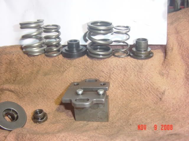

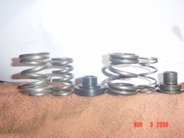

Thanks, supposedly the PO installed a plate, I think he said zero, I'm not sure though. I ordered a 4k kit, but I will just put the 3k springs in. I haven't looked into the timing yet and I'm unsure of what exactly I'm doing when I move the AFC forward at the moment.

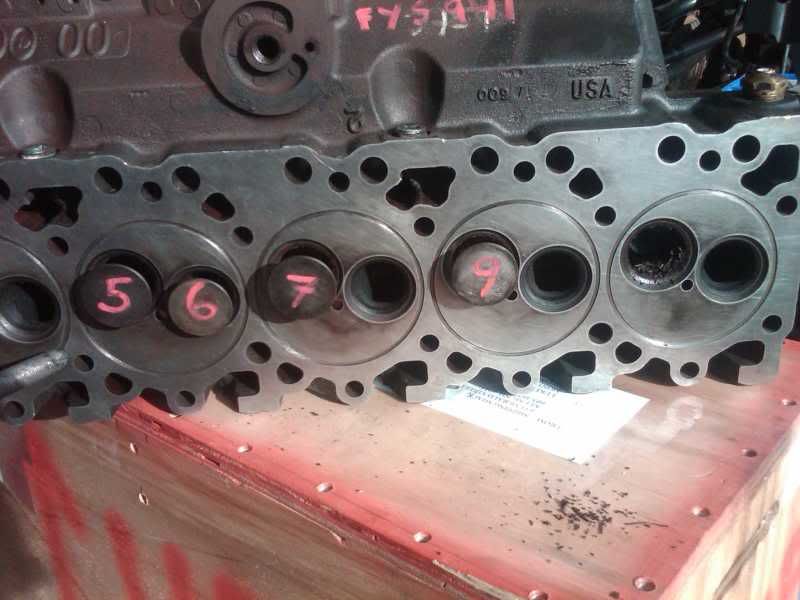

If I pull the head off do I need to O-ring it, I've read that if you keep it relatively tame that the stock gasket is fine. I'm really wanting to just get around 20 mpg and have enough power to pull 10-12k.

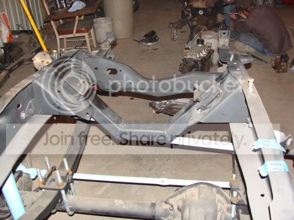

I also got to thinking I'll just get the avalanche engineering crossmember, It will make things so much easier. Considering the fact that I would feel comfortable putting a cummins on any engine stand I have, or if it would even bolt up. I remember lining up my big block was a big enough PITA, let alone something twice as heavy.
no no orings are not neccissary. for sure.

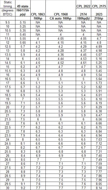

there are pump timing charts for each pump. the timing kit allows you to measure off the top of #1 plunger and distance measured for each pump relates to a number in degrees BTDC.

timing makes a big difference in how the engine operates. as the 6B is static timed. there is no injection advance mechanism at all on a P7100 pump. and very likely it has slipped since new if no ones done it since new or if its been done incorrectly at some point. base timing is around 12*-13* for emissions. the engine is far happier at 15-16 even totally stock. and even higher the more modified it gets. you do have to worry about the HG and cylinder pressures at some point over 16* if you stay under 45 pounds of boost and 16* timing the stock headgasket should be fine. you could run a retorque on the stock bolts for good measure.

doing governor springs is 100x easier when the engine is out of the vehicle and on the floor. I'm not whinin about doing it in chassis, but christ if its on the floor do it then. everything else is cake. and essentially free. so why NOT do it now :waytogo:

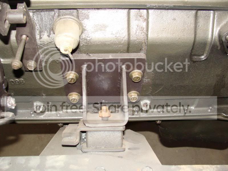

None really, just wanted to check it out. What motor mounts did you use?
I made my own using the stock cummins mounts on the engine. I made new frame mounts for the engine mounts to sit in. I decided to use the stock cummins mounts because obviously dodge/cummins used that design for a reason, because it worked.
I'm partial to the idea of using the stock gm mounts, I'm not convinced they're made to handle that kind of weight.
Lastly, when at all possible I make things unboltable. Sure makes things easier in the long run
