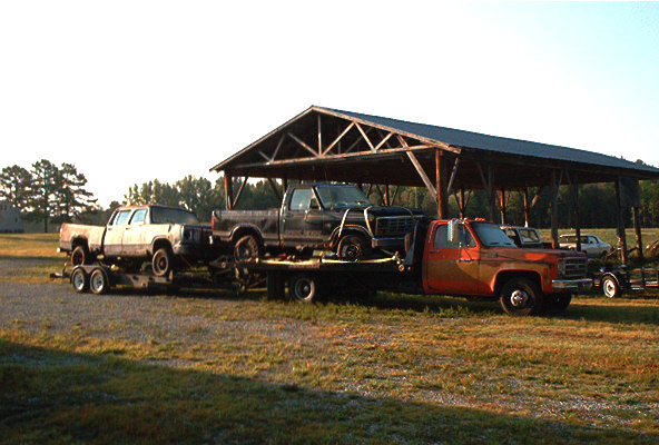

I have a 1977 Chevy 1-ton 2WD Rollback tow truck (has steel Jerr-Dan bed that tilts). It currently has a 454 and SM465 4-speed. Unloaded it gets 10-12 mpg, and pulling 2 rigs (one on bed, one on trailer) it gets about 6.
