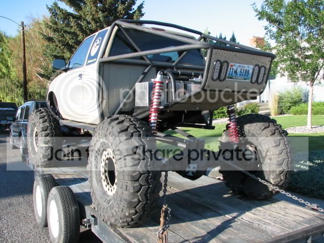

Current re-built of my 71 K5:
$660- Shocks
$280- truss
$450- joints and some brackets
$ 90- more brackets from poly
$ 40- used btf brackets
$200- DOM for links
$100- inserts and jam nuts
$200- used c/o springs
$ 2020 than add misc little things would probably add up to $2100
Some things could have gotten cheaper or built more brackets instead of just buying but its cleaner this way. My DOM was also high $$ too because my links had to be so long and I also used 1/2" wall on my lowers because of the length and leverage on them
There's alot more to it than just "slapping on 4 link bars". Also if it is a dual purpose rig (i think many are) links don't live very long on street duty (the ends will wear out quickly). Then there is the extreme amount of cost involved.
