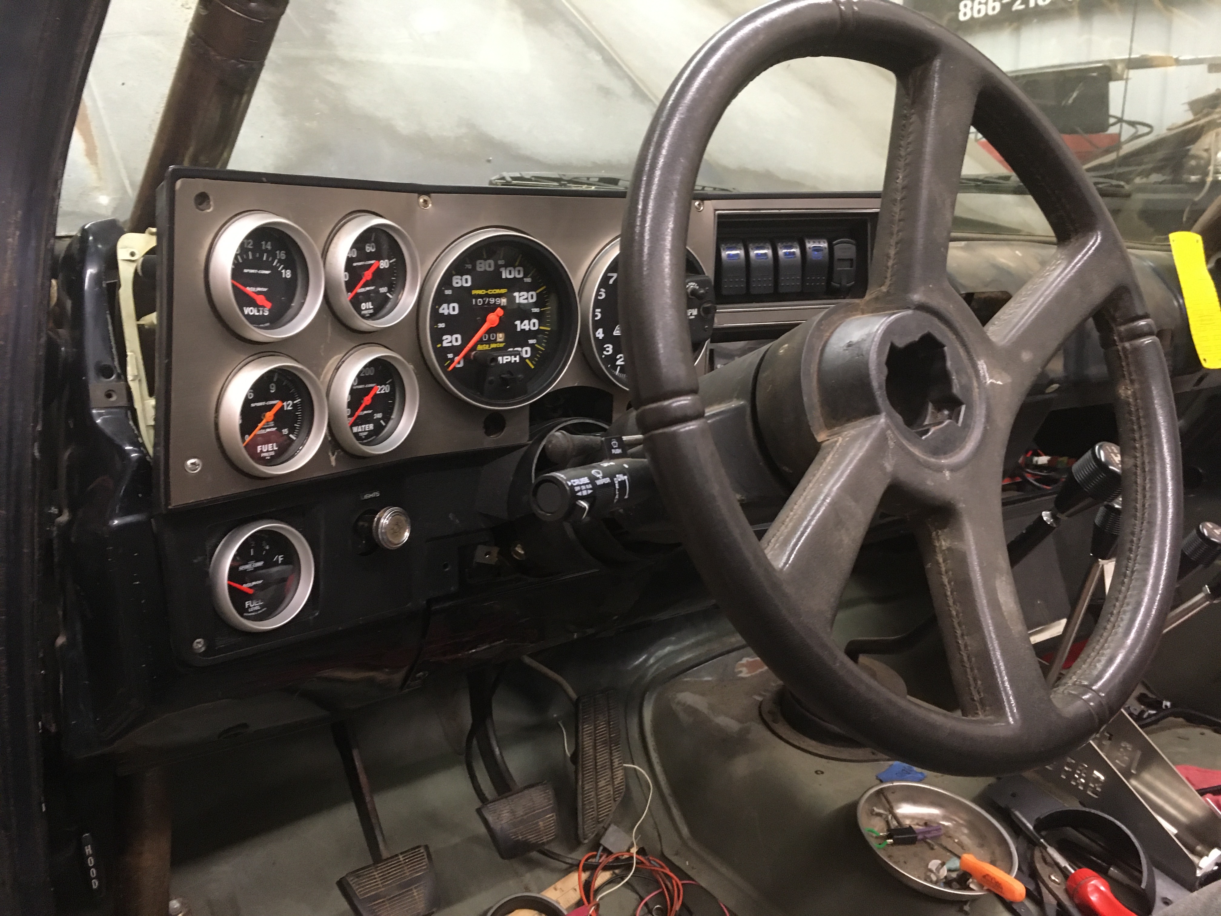

I used a hole saw to open the stock holes on my bezel (as evidenced by the bite mark where I got careless). The problem I ran in to was the depth of the aftermarket gauges prevented my from using 95% of the original cluster "bucket", I cut it all away except for the perimeter that was needed to screw the bezel too.

Similar to ct-blazer, I kept factory speedo and added a speedway motors c60 repro tach/fuel gauge(which recently quit working :frown) then added autometers in the factory 4 holes. Edit: in ordered a new clear speedo and fuel/tach lense for a truck with dummy lights to avoid cutting one. The onboard air gauge and compressor switch are in the repurposed ashtray(stole that idea from someone on here I think Daniel Palms?) Has been this way about 10yrs:eek: time flys. Need to clean the interior it looks like!

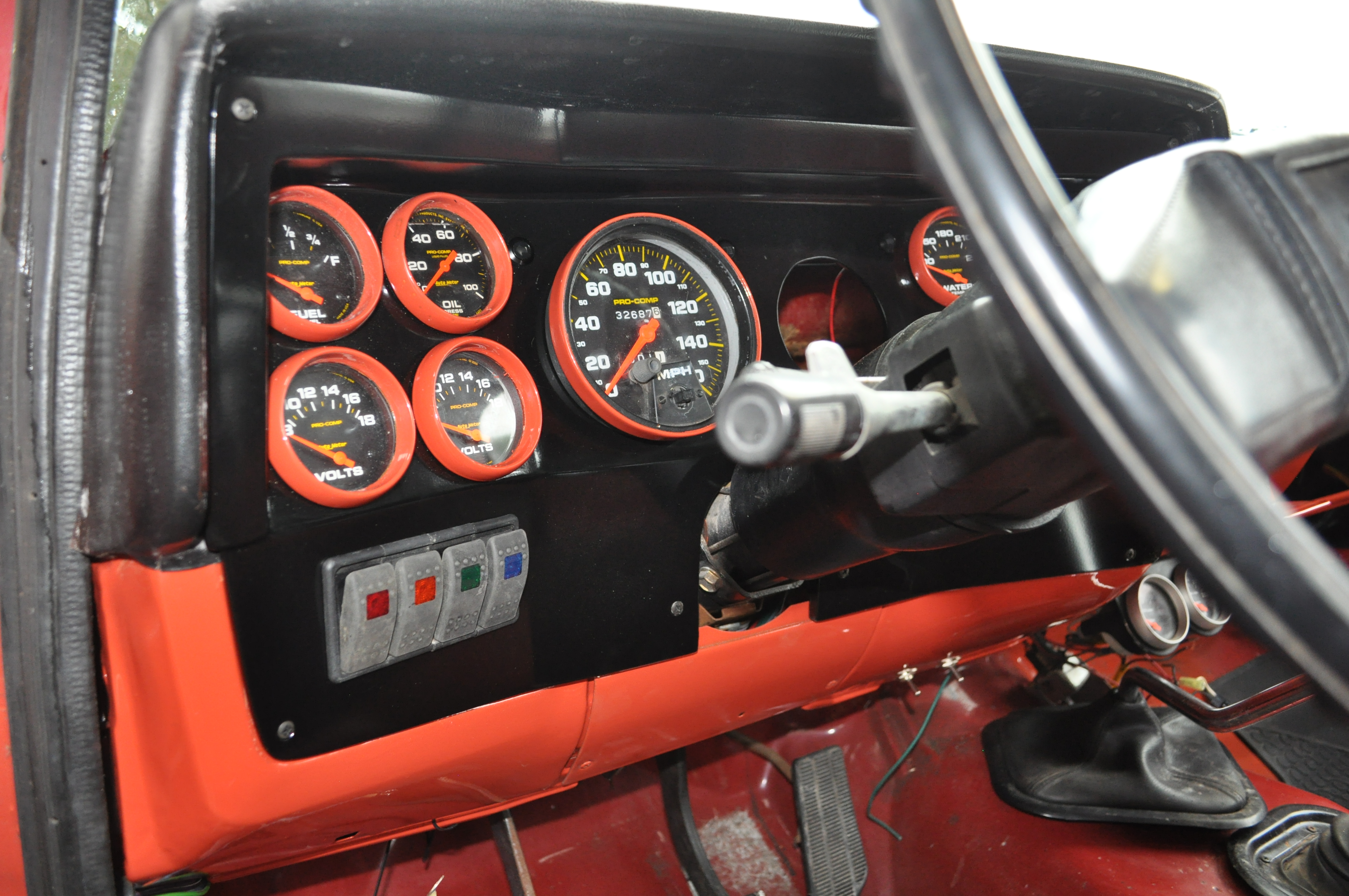

Here is my setup...did it about 2005 the first time and around 2016 was the black bezel redo...speedo is a cable setup and I went to a 1989 TBI setup with a cable speedo/sensor behind the dash so my factory speedo is still hooked up under the dash to get a speed signal to my ecu.
