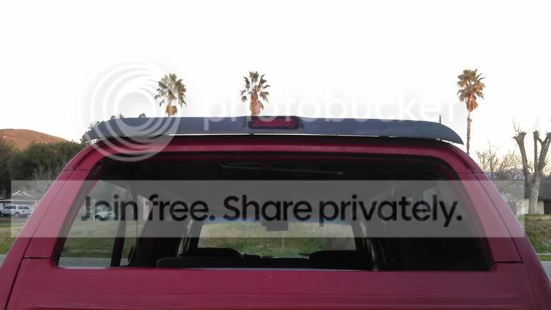

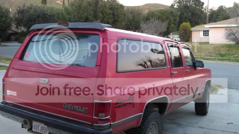

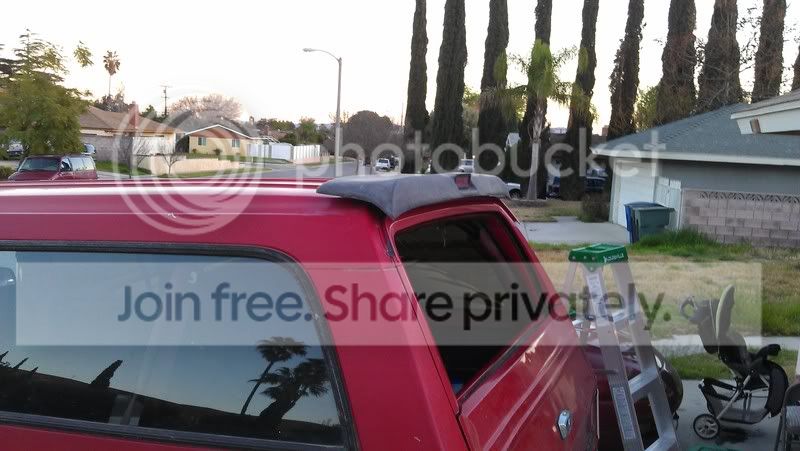

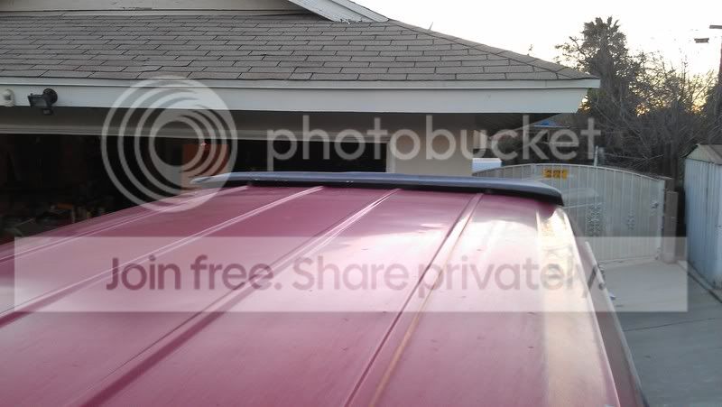

Hey guys I finally got around to installing that Junk yard pull from a few months ago.
From as much as I can tell this air Dam/Spoiler was made by "Travelmaster"? I have honest ly never seen another one like it. I was in the market for the adjustible metal ones seen commonly on our trucks but this was just to unique to pass up.I pulled it off of a 1989 v1500, with all the gaudy wood trim and some nice fiberglass fender flares(but they were destroyed)...
I think i am going to coat it with Bed liner and repair & Wire up the 3rd brake light. What do you think? Should I paint it body color or paint it black(bed liner)
Here are some pictures... What are your thoughts?

Haha, probably right I have no illusions of Performance boosts basic laminar flow perhaps,Haha , just for looks, something different than I have seen.Strangely enough the rear of the truck is what does not get dusty anyhow HAh! I am going to do a coat of body color see what it looks like then make a decision.
