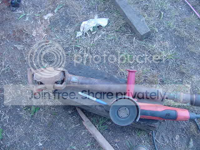

I suppose I need to clearance grind my CV shaft, to allow maximum flex. The RC lift pdf I downloaded told me to, so I took off the shaft. I marked the area I want to grind off in blue. Is the the only place I need to grind off, and does it look like I've marked a big enough area? I'm obviously gonna grind the mirror image of it on the other side of the CV.
Also, how the heck do you get grease in the CV? What kinda grease, the red stuff I suppose?
please critique my grinding area before I dig in.. I'm gonna give this thread about 45 minutes or so before I go and do the deed.. so let me know if I'm on the right track :bow:

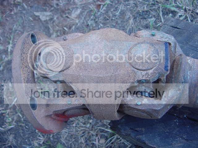

Yeah James, general rule, don't cut any deeper than the skinniest part thats already there around the brg cup.

Grind everything that hit's. Grind on the thickest side.
There is the nut shell way to do it.
Just don't grind to much.

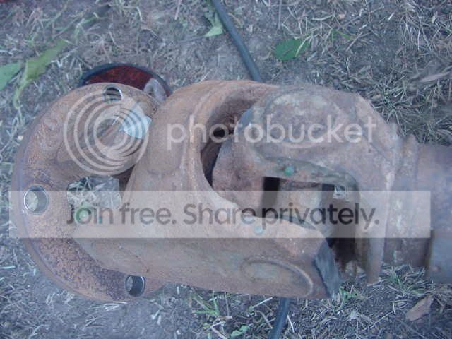

I just ground off the part I colored with the sharpie, but it doesn't even look like anything that would ever have a problem clearing... that was probably a waste of time.. now what DOES look like its binding are some raised triangluar areas.. 4 of them to be exact.. when I move the CV around, those do bind up against the center section.. guess I'll go grind those, as they may actually be a clearance isssue...
I ground a good big of crap... its should have more travel before its binds now
I would suggest taking it apart. Get the best joints you can, and replace the center section parts. You haven't got all the bind points out, here's my crappy paint chop of your photo. If it binds at all under flex, you'll break the center, I know, been there.
And you should probably replace the u-joints while you have it out. Those look like the original ones.

Check Tom Wood's site, tech info/1350 CV pros/cons........for clearancing the ball & socket area.
I thought I had almost ground too much.. guess I'm needing to grind more :eek1:
