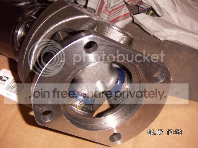

For the rear, you don't have to do SYE in order to do a CV, but it is nicer. AFAIK, Tom Woods is the only ones selling a SYE for the 208 and it's a package deal, buying the shaft from them as well and having them machine your current tailhousing. I did a SYE and used a stock front output flange on the rear output and had the C/V built to match:
The advantages were just to save $100 for the custom flange use a readily available part. (If the lengths weren't different I could also swap the shafts front to rear)
