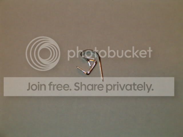

I know it goes on the pads somewhere, but couldn't find a pic of it in place. When I took my calipers off, the bottom hardware was in place, but not the anti rattle clip.
Where does it go?
The clip attaches to the inner pad and then snaps into the caliper piston.
On the inner diameter of the pad...closest to the hub?
Yes, closest to the back side of the wheel hub not the locking hub.
