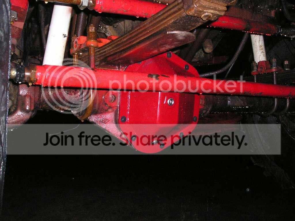

You need a steering box from a 2wd truck close to the same year as yours.

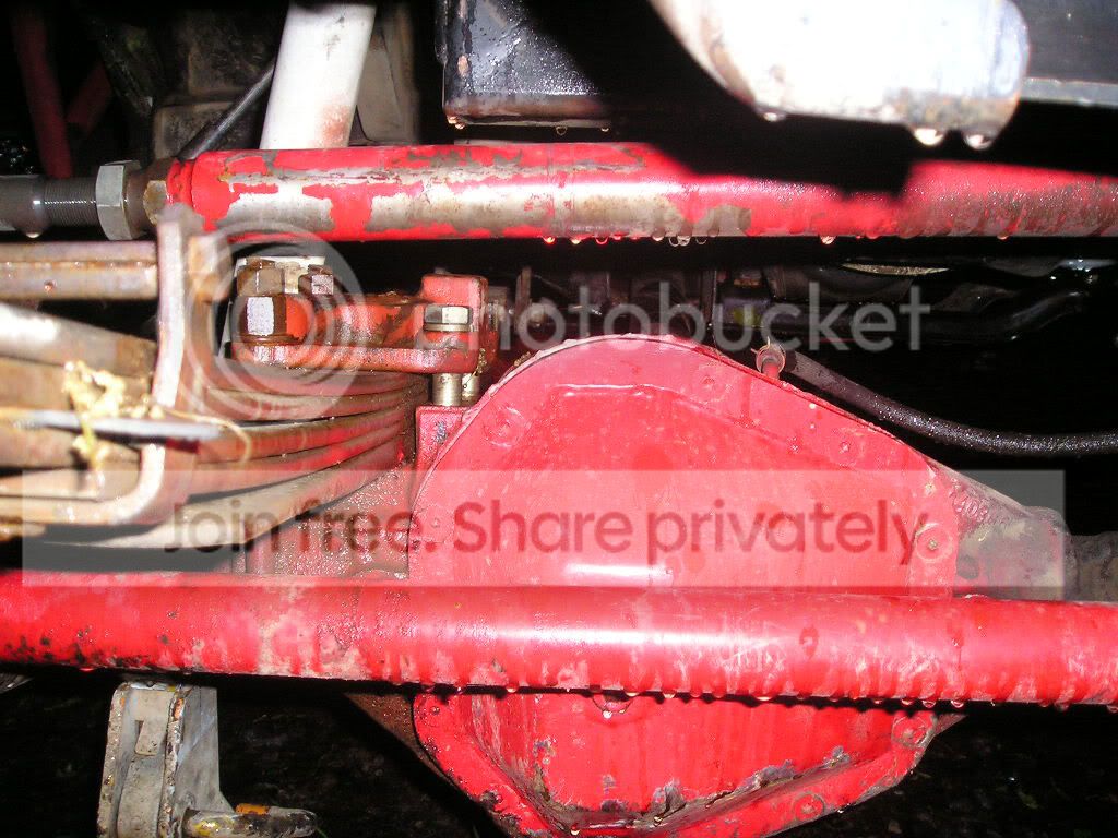

1.75" is about as big as you should go. Between 1.5-1.75" is pretty normal. This is also somewhat dictated by what size tubing your tube inserts were made for.
This is how my old rig was setup. 1.5x.188 wall sleeved with 1.75x.120 wall. Should give you an idea what 1.75 stuff looks like.
Bungo, I have no idea what that is? Do you mean bung? :confused:
What arms you get depends on what style steering you want to run. You basically need to decide if you want your tie rod in front of the axle in the stock location, or above the springs and behind the axle. Then you can pick out your arms.
Check out http://www.wfoconcepts.com/Steering/Dana60/listing.html for steering stuff. Trevor makes some bad ass parts. :D
