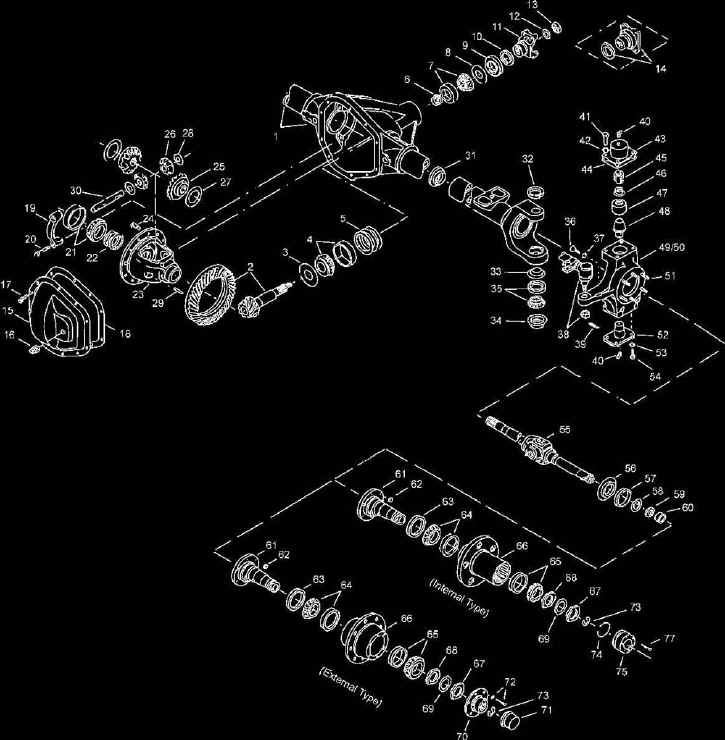

Dana 60 regear
Here is an exploded view from pirate:
No. 3 is the inner pinion oil slinger and No. 8 is the oil slinger that goes between the outer pinion bearing and seal.
PaulC
