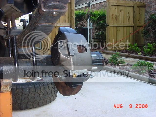

Mine is kind of a "special" case, my axle has been narrowed to match a van width 14 bolt (between the flange and hub seal surface). I left the original flange and welded to it a new round flange made from 1/2" plate with the caliper bracket bolt pattern. The thickness of the new flange and the bracket spaced things out perfectly to fit the caliper on the (D60) rotor.

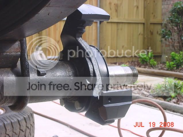

Here's a few pics -

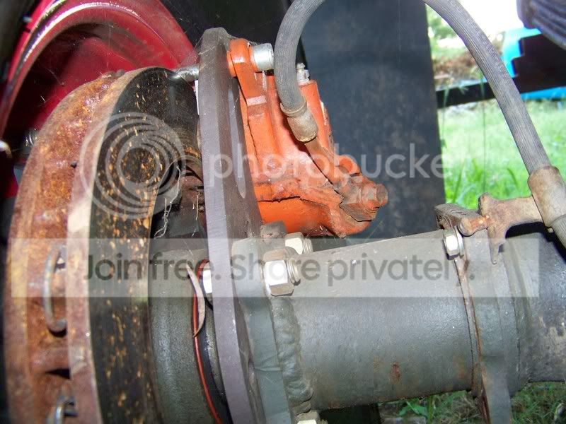

This pic is a good example of welding on one of Kerts flanges in a new spot so the parts line up. This is what you'd need to do on a 70HD otherwise the spacer between the flange and caliper bracket would be about 2.5" thick.
(stolen from the 14 bolt hub on a 70 thread thread)
