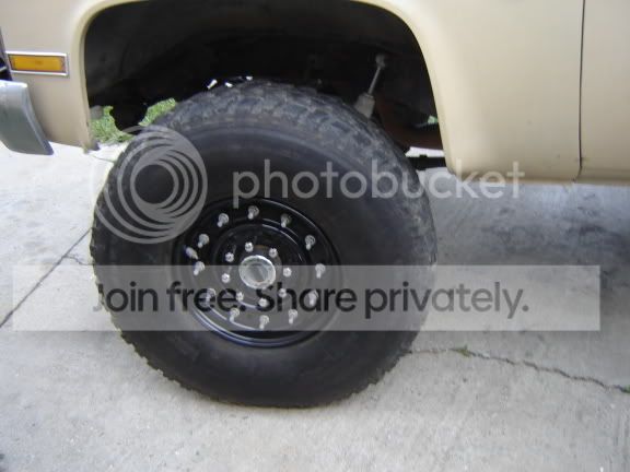

Heres a pic of my once stock dually K30 with stock 12 bolt hummer rims and tires on it. I did nothing to either axle, just bolted on the rim and tires. It drives fine, in fact I can actually tell no difference with the way it rides, steers, or stops. Due to the stiff springs and the fact that I can turn the pressure in the tires up to 50psi if need be (for towing or heavy loads (like when my girlfriend gets in the truck:haha:))
