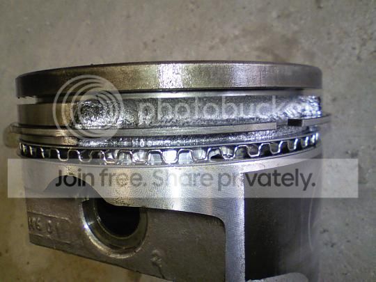

Got the motor in and running. Then proceeded to blow the motor. (Problem was Detonation) Not once....but twice....in like 5 months time. Say it with me brothers I WANTED A PROJECT CAR. :doah:
Here is one of the pistons that had not even 200 miles on it.....

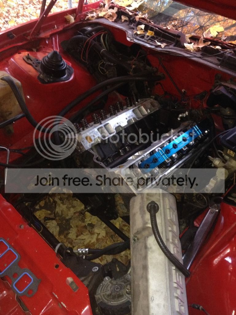

Next up was doing the Cam/Head/Intake swap. I worked on gathering my parts up until fall 2013 to do the swap. Went with a pair of Edelbrock Performer RPM heads. A Comp Cams XFI 280 Flat Tappet cam. And a F.I.R.S.T. intake from F.F.I.
Some pictures of the install. Here is a link to a video of the exhaust. It has Dyno Don 1 3/4" shorty headers on it with the Y-Pipe for them. Then it goes into a SLP Loudmouth II exhaust system from a 4th gen car. Sounds mean as heck.

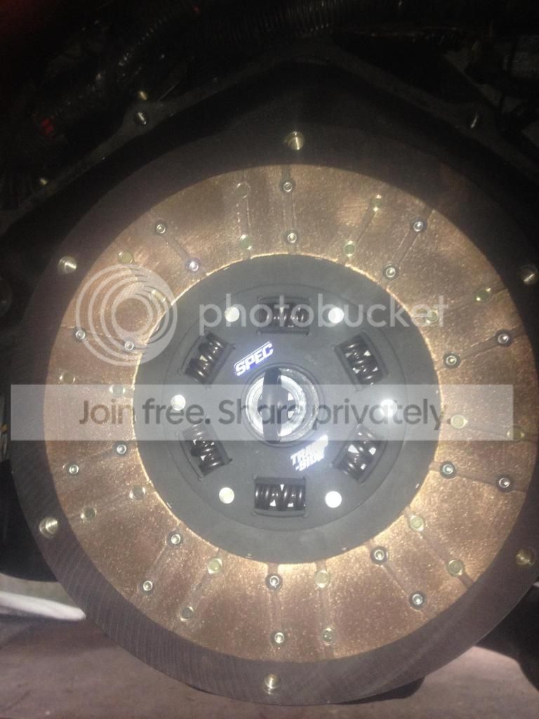

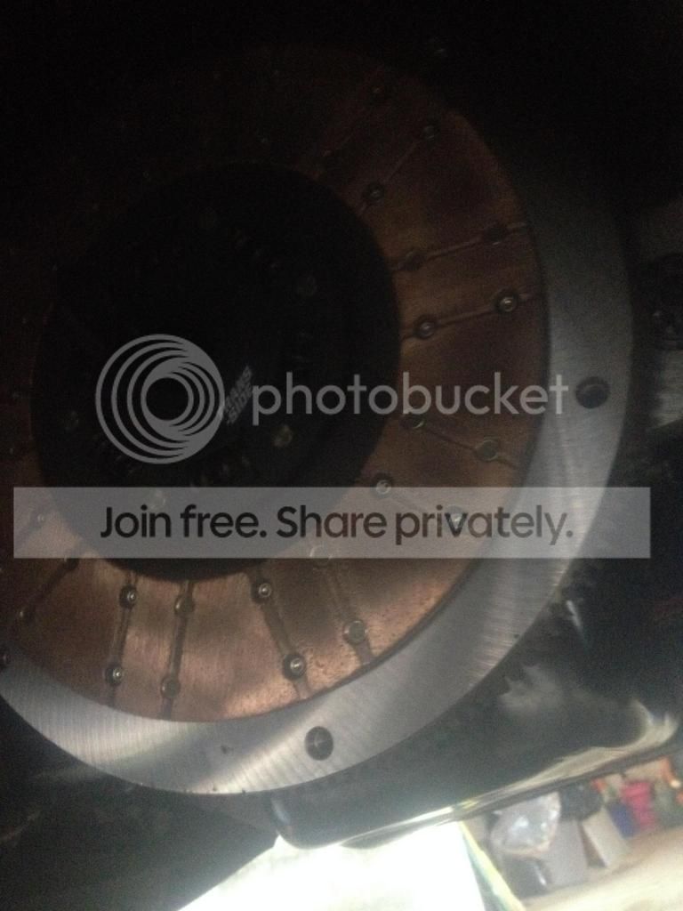

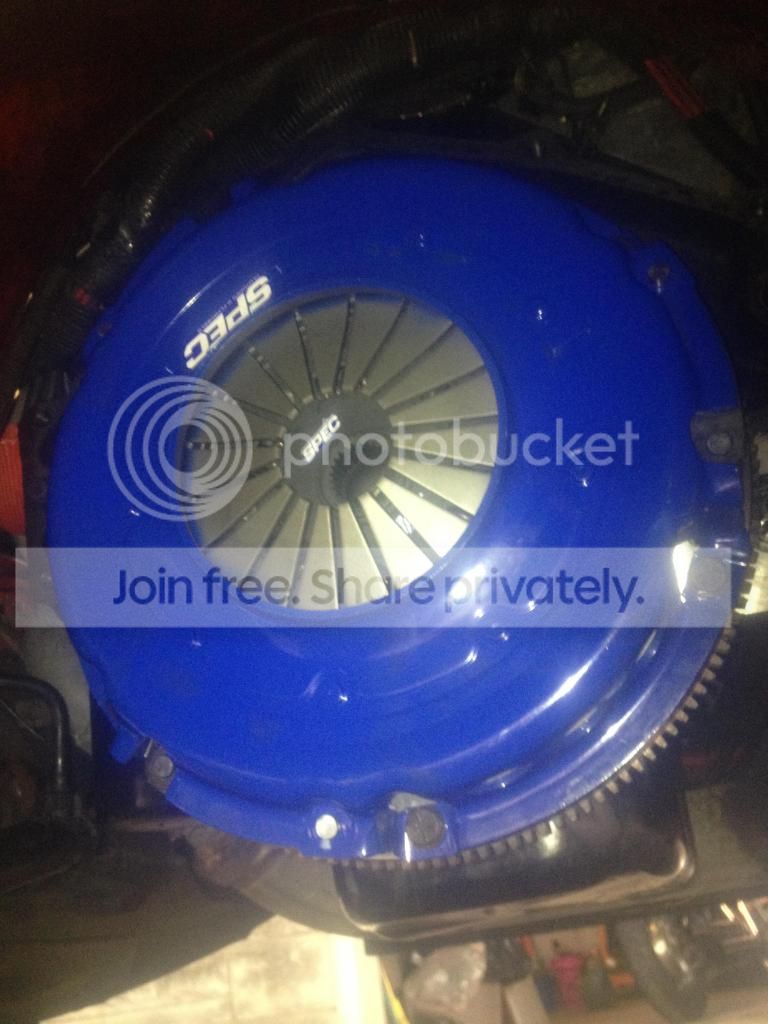

Then I thought it smart to take a trip to the drag strip. First time ever doing that....found out pretty quickly that I need more traction AND that the stock clutch that I had installed in it when I first put the car together wasn't going to last much longer. Considering it was the clutch that I learned to drive stick on I was shocked it lasted as long behind that motor.
So I installed this.
Spec Stage 3+ Clutch with a freshly surfaced Centerforce Flywheel part # CTF-700102. Figured that would hold up.

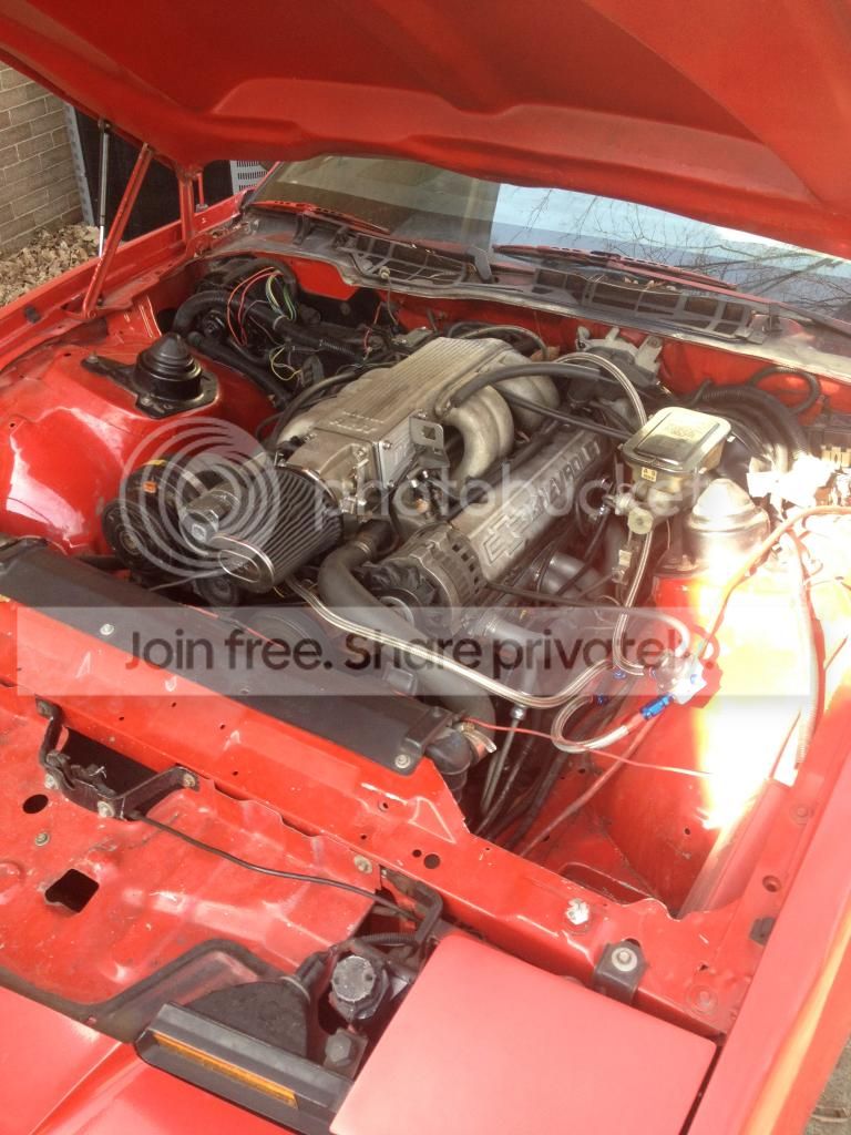

Details on that intake?
Martin
Its basically a larger version of the original TPI intake. Made by a company called First Fuel Injection. It is a completely custom intake with non of the stock pieces being interchangeable. It uses a large monoblade throttle body as opposed to the dual blade throttle bodies found stock.​
https://www.firstfuelinjection.com/ Here is their site.
This intake has been around for several years when it was made by a different company. I guess it never got a lot of advertisement and due to it being expensive just never took off. Anyone I have seen that uses it gave nothing but good reviews.
I would give it the same good reviews, this thing pulls like a mad man. Even with a Cam that has a advertised range of 2400-6400 it still has plenty of torque down low in the rpm range. Then once it hits about 2000 rpm it just goes all out. I would love to get it on a dyno after I get the new transmission in. There is a place about 30mins away that has a chassis dyno. Wasn't crazy expensive to get a few runs to be able to tune on it.
