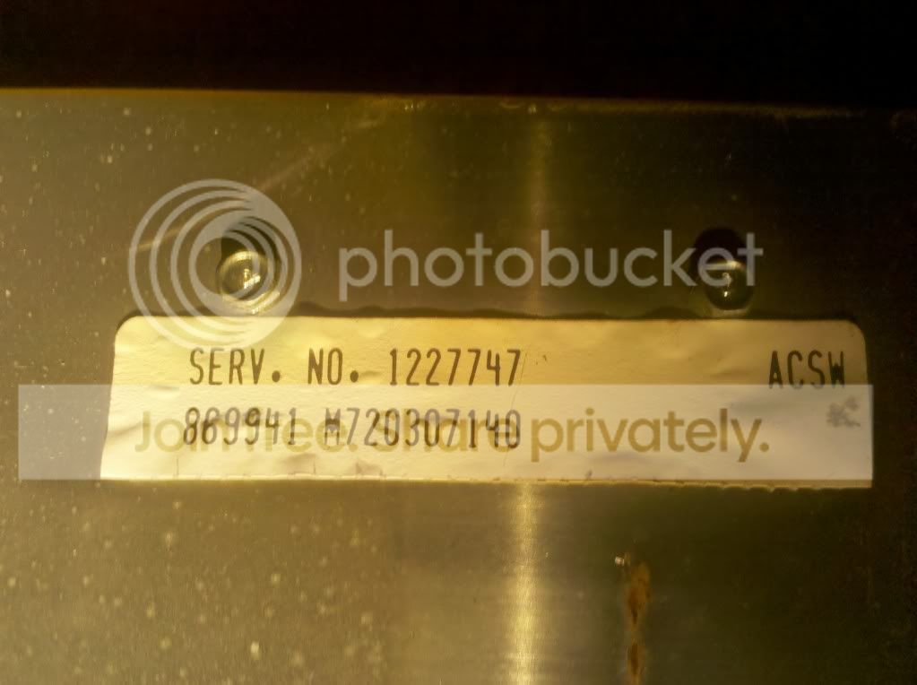

Dave, here is the lable from the ECM.

Hi munepit, It's nice to hear things are working good with the computer and custom PROM. I think we were lucky the weather out here on the west coast, for the almost 900 miles the computer had to travel was good.
I also deleted code 42, knock sensor. I think the real key to helping out was when we talked on the phone and you commented that when error code 43 would set, the engine lost some performance like the timing was being retarded. Broadcast Code ACSW does not use "Burst Knock Retard", but maybe your OEM ACSW PROM was programmed to use "Burst Knock Retard"?:dunno: The custom PROM chip you have Does Not use "Burst Knock Retard". I really did not delete the EGR, the EGR will work should you ever decide to drive 255 MPH.:D
