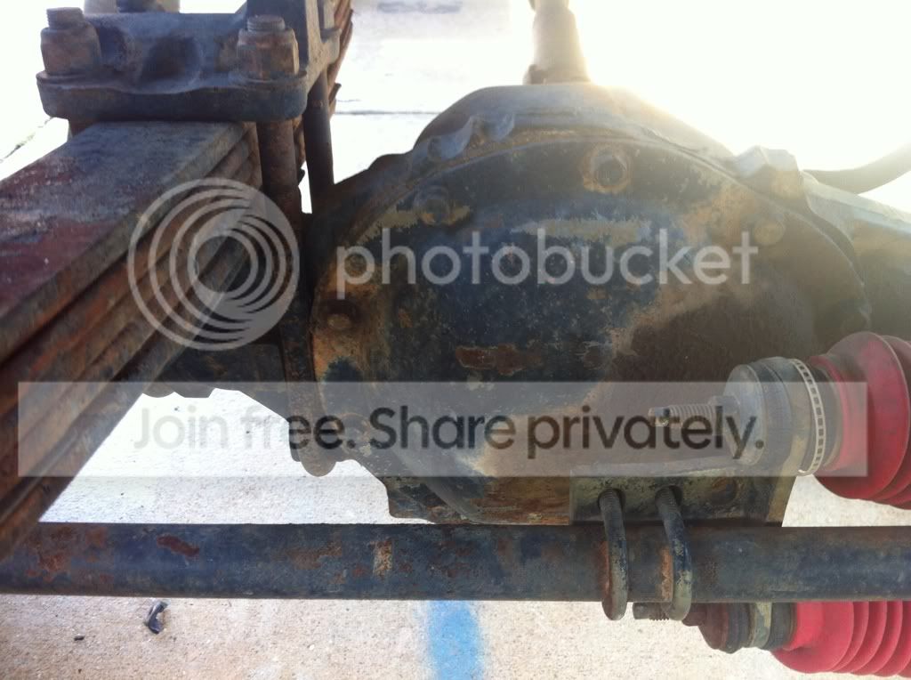

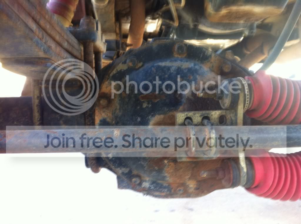

I recently detonated the entire outter half of my axle. I was at the auto skills shop here on ft benning and the guy there couldnt distinguish between anything to tell me what I need. I was hoping I could post a few pictures of what i have tomorrow but may be able to articulate it through writing. HERE WE GO!
I took hub and the brakes and what im assuming is the spindle. attached to said spindle was a bearing that was demolished after using a press and all sorts of ingenuity I was successful in removing that. Now attached to the truck is nothing there is just a small shaft sticking out. My big question is what do i need to replace from that small shaft out. I will post up pictures tomorrow as soon as possible but I have a weird feeling that I ordered all the wrong parts. I picked up 2 bearings the "inner" and "outer" wheel bearings timken set 37 and 45 respectively secondly I'm not even sure im working with a dana 44. i know be gentle

Its a 10 bolt, much more common than a D 44 and nearly identical in strength.
There are 2 44s if its an early one it used smaller bearings the 10 bolt and later 44s use the larger bearings they are interchangeable. In fact most parts knuckle out are interchangeable from a 44 to a 10 bolt
77+ i think they started using 10bolt fronts. Someone im sure will chime in and give the exact date.
its an 8 lug so im assuming its from a 3/4 ton. would it make any difference on the outside like that?
All the 8 lug 44 and 8 lug 10 bolts used the same bearings. I have used spindles from either or.
biggest difference in 3/4 to 1/2 ton is brake mounting system.
I had a 10 bolt that had the outers on one side from a 44 ( 8 lug) and the other side was a 10 bolt ( 8 lug) spindles out

Look for a late-70's through '87 K20 (3/4 ton = 8 lug) pickup, or up through a '91 3/4 ton Suburban. These should have 8-lug 10-bolt front axles but double-check. You can verify but matching the diff covers as the 10-bolt has, well, 10-bolts and is round-ish in shape with two "ears" hanging off each side at the bottom of the housing. There are some good pictures on here for reference.
Some parts from some D44's will work but you have to be careful to match them up.....based on what appears to be your experience with this axle I would just concentrate on finding the 8-lug 10-bolt front axle and either take all the parts off of it. Strip it down to the same point as your axle and put all of those parts in a box and go, or maybe even find a complete axle (around here they go for $100-$150 for a complete axle).
