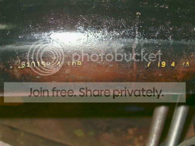

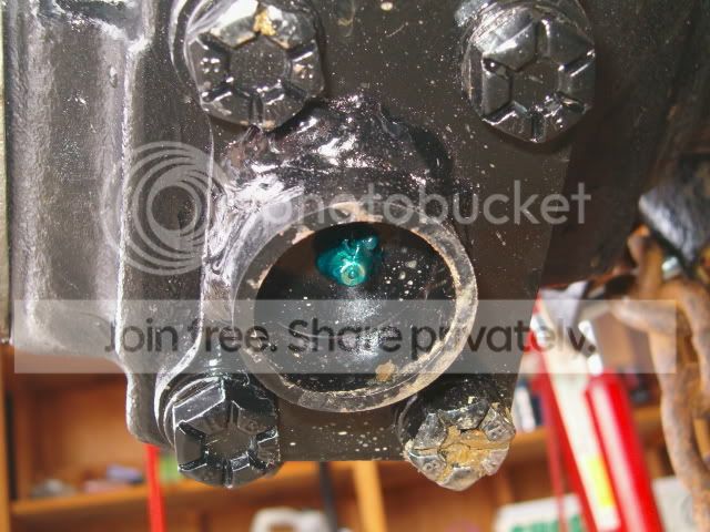

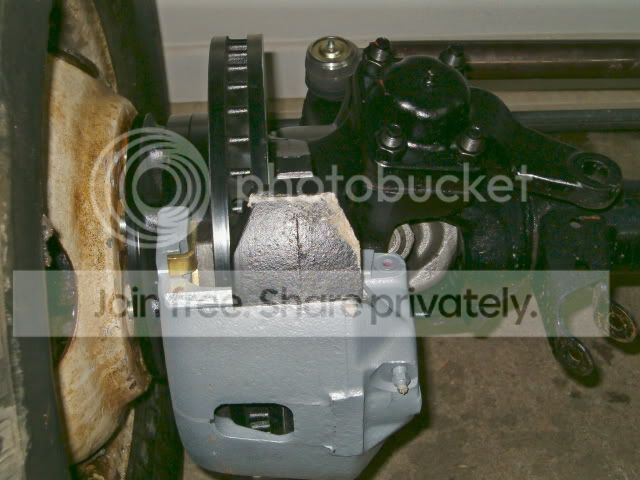

a GM 60 will have 60F in the lower webbing on the drivers side front. It will have kingpins, and 1480 ujoints at the knuckle.

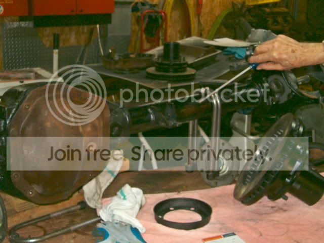

look here:
it will look like this:
If its a 60 it will be here:

The kingpin knuckles are the easiest giveaway.
